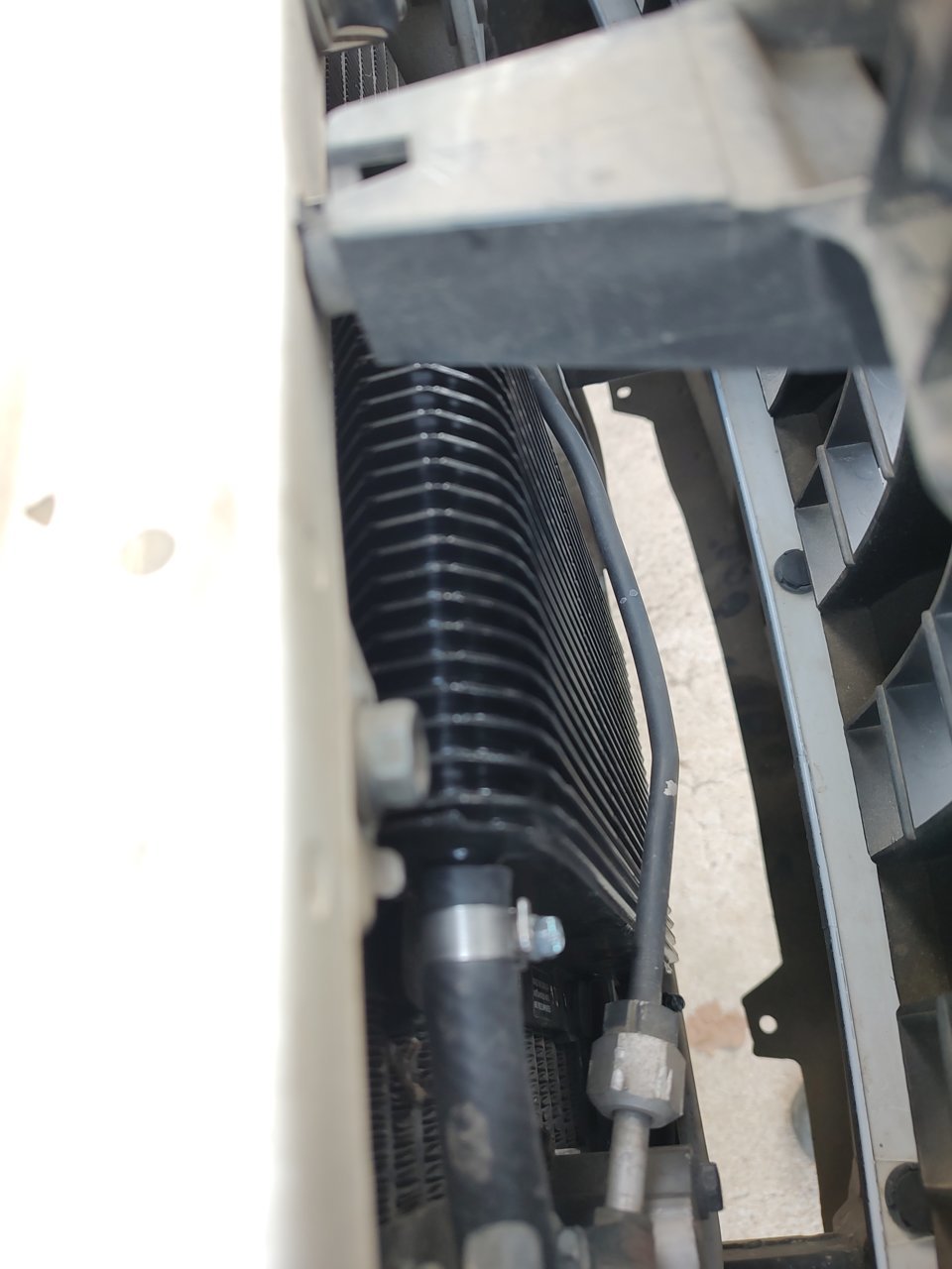

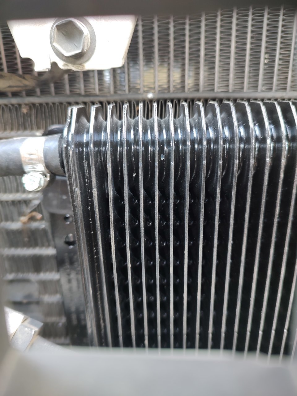

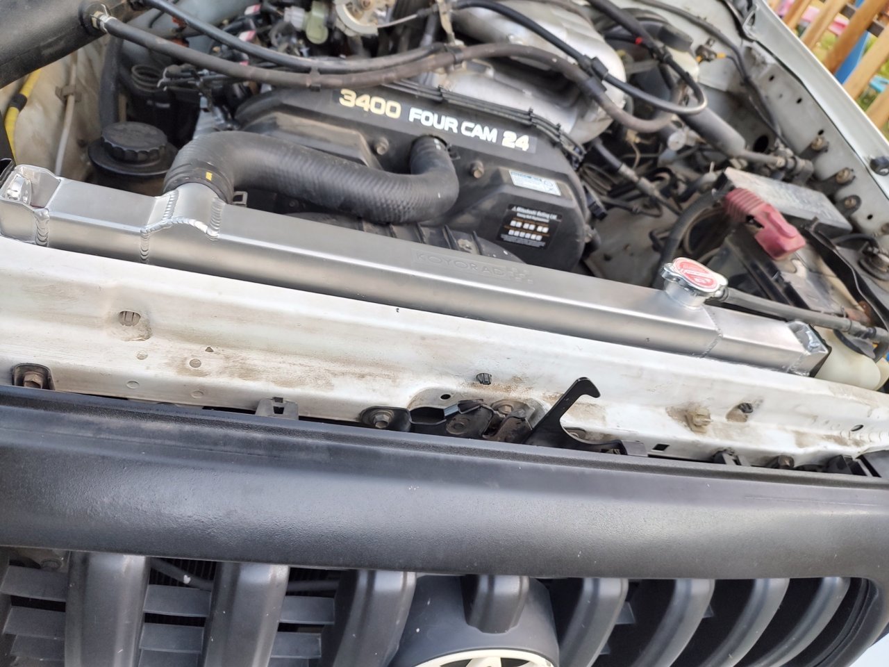

    Before doing this to my truck researched a lot on getting rid of my crappy plastic radiator and I could not find anything on what I ended up doing. Koyo makes a radiator for the 4x4 manual Tacoma and this is the one I purchased. Part ( VH010513 ) that requires a new cap part ( sk-c13 ).
    I chose this over the champion radiator for a couple reasons. I have seen reports of fitment and durability issues with the champion rad and honestly I didn't want to cut or do anything to my hood etc.
    The koyo rad bolted directly into my 2002 Tacoma V6 engine bay and has 0 clearance issues. This radiator does NOT have a transmission cooler and it is thicker and shorter then the factory radiator.
    Requirements for use:
    1. must shave cutouts on fan shroud if installing on an automatic because the drain port and the bottom hose notch needs to be higher because the radiator is shorter.
    2. The bottom radiator hose should be switched to the 4x4 hose for the best fitment, or cut the OEM automatic hose at your own risk.
    3. Install a stand alone transmission cooler. I chose a b&m for now but I'm still monitoring temps and summer is coming.
    Pics.
    IMG_20220214_072951820_HDR.jpg IMG_20220214_072957671_HDR.jpg IMG_20220214_073020879.jpg

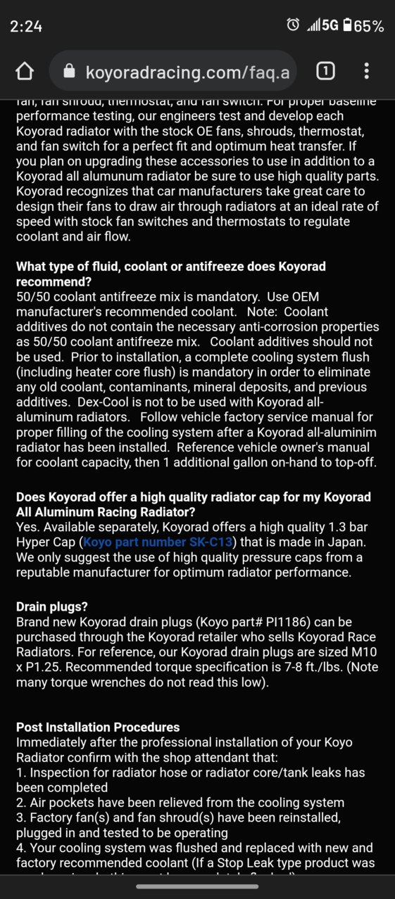

    According to koyo they only say do not use dex-cool. The radiator I got from them seems pretty beefy on the top and bottom and installed with bushings on the bracket so I'm hopeful it lasts at least a year or 5 lol

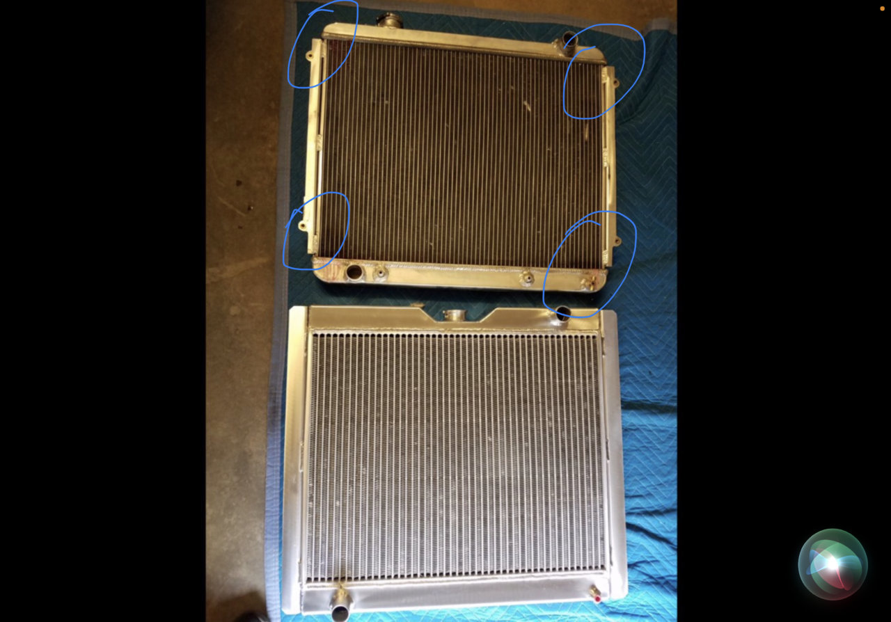

    This radiator on top is a champion radiator and you can see how it’s NOT boxed in on the corners making it a weak design

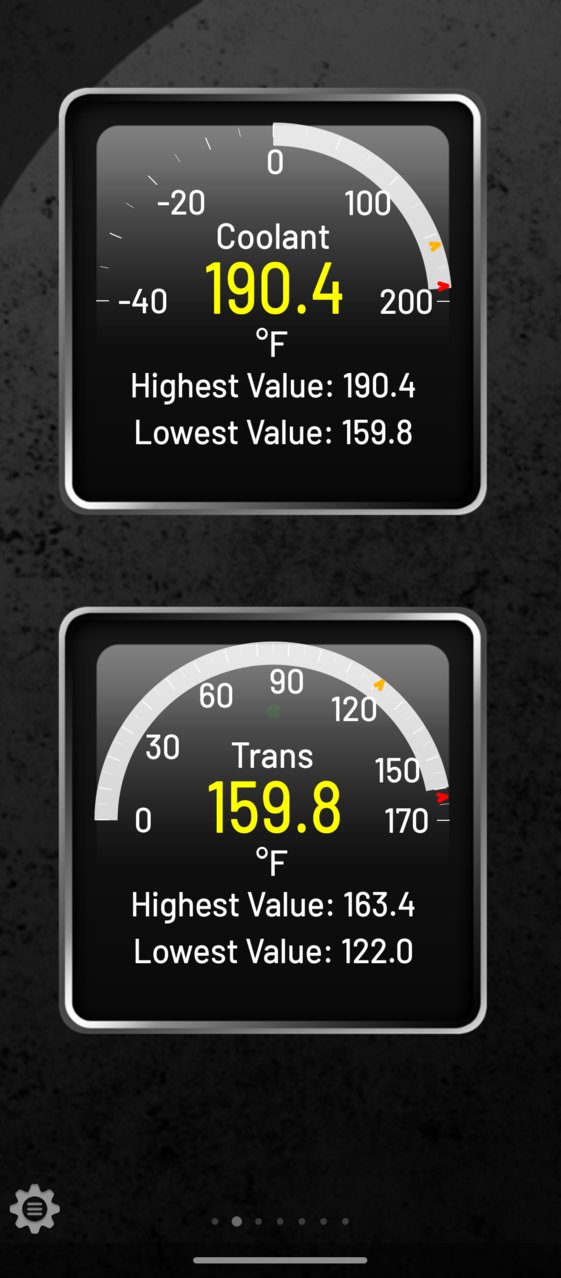

    I have about 4500 hundred miles on it now with no issues and in that time taken two road trips up and down elevations. The trans cooler tube came loose a little bit but that's about all. No coolant leaks or anything. Been extremely hot here and I haven't had any issues.
