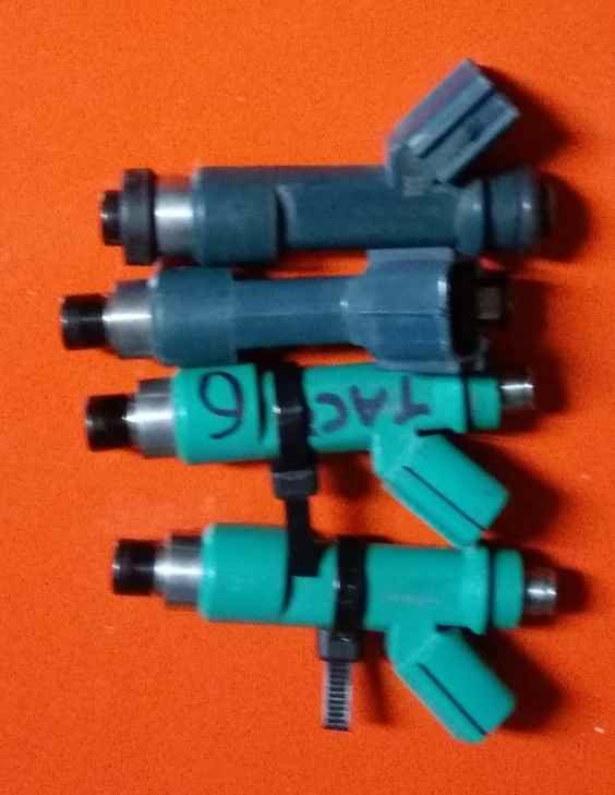

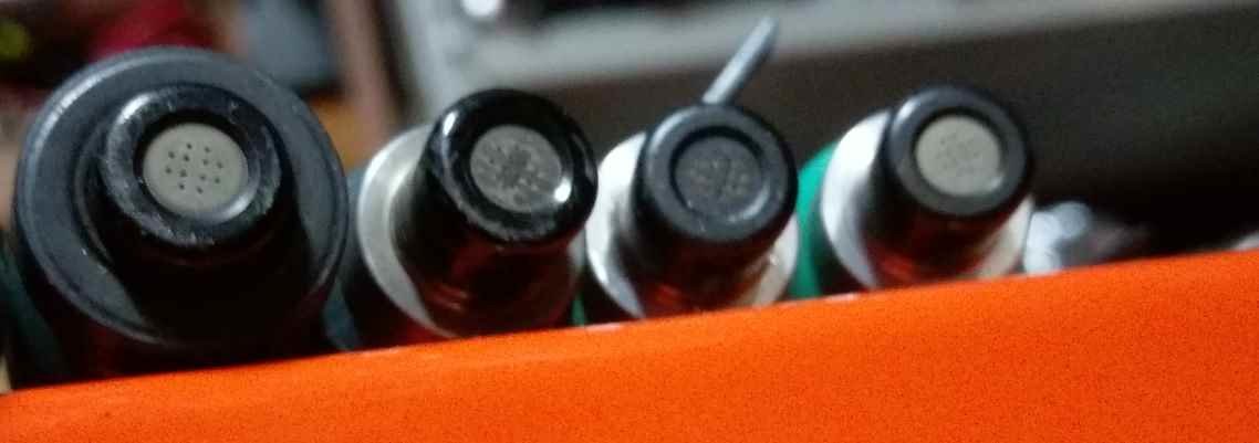

    Some of you may or may not know I have been involved in a lawsuit with Toyota for approaching 2 years now. We thought it was going to settle months ago, but... Although, I love my Tacoma, will never sell it, and plan on my next purchase being an FJ! (FUCK TOYOTA on this, you guys need to know!)
    The whole problem started almost 2 years ago when my head gaskets failed and Toyota not admitting that there was an issue with heat and 1GR-FE engines manufactured between 2004 and early 2006.
    Everything below is to be understood as an "hypothetical case" ... fictional, whatever removes myself from any liability!
    After examining several 1GR-FE engines, from Tacoma's and FJ's, manufactured between 2004-2008 an anomaly may have been found. Again, all hypothetical, but Toyota seems to have been making slight alterations to coolant jackets in the 1GR-FE engines due to over heating of the rear cylinders.
    This affects the head gaskets and now, I think we discovered the fuel injectors to! Almost all engines examined suffered from varying degrees of gasoline smell in engine oil. Once removing the upper and lower oil pans every engine except the 2009 FJ engine showed "red' streak on on the wall of cylinder 6... meaning... well you know... fuel injector stuck/leaking.
    The the 2009 FJ, same symptoms, but cylinder 5.
    Here is the kicker... engines manufactured between 2004 and 2006, the affects were way worse. Between 2007-2009, less, until the point where the 2009 FJ was on another cylinder. Maybe coincidence, but it matches Toyota's revisions to the jackets.
    This is why this is very IMPORTANT!
    Believe me, don't believe me, but I am sharing this for your benefit.
    The cooling of the cylinder seems to not only affect the head gasket, but also affects the fuel injectors on the rear cylinders! Why does this matter???
    When the fuel injector is over heated, it can get stuck open!
    Anyone want to chime in here???? The fuel system stays pressurized so when you wake up in the morning to go to work, your 1GR-FE is ready to go! If an injector is stuck, while you sleep, gasoline leaks into the cylinder, past the rings, into your engine oil, which degrades viscosity.
    Long story short, if you pull your dipstick to check your oil, or change your oil and it smells REALLY strong of gasoline, pull at least your lower oil pan and send an endoscope in to inspect cylinders 6 and 5 for signs of leakage. Will save your engine!!!!!!!!!!!!
    (injectors on the left are from 2008 FJ 1GR-FE, the first injector from the left is one of the other injectors, the second injector from the left is cylinder 6, on the right are from 2005 TACOMA 1GR-FE with cylinder 6 the 3rd injector from the left and the last one from one of the other cylinders.
    More to come, stay tuned!
