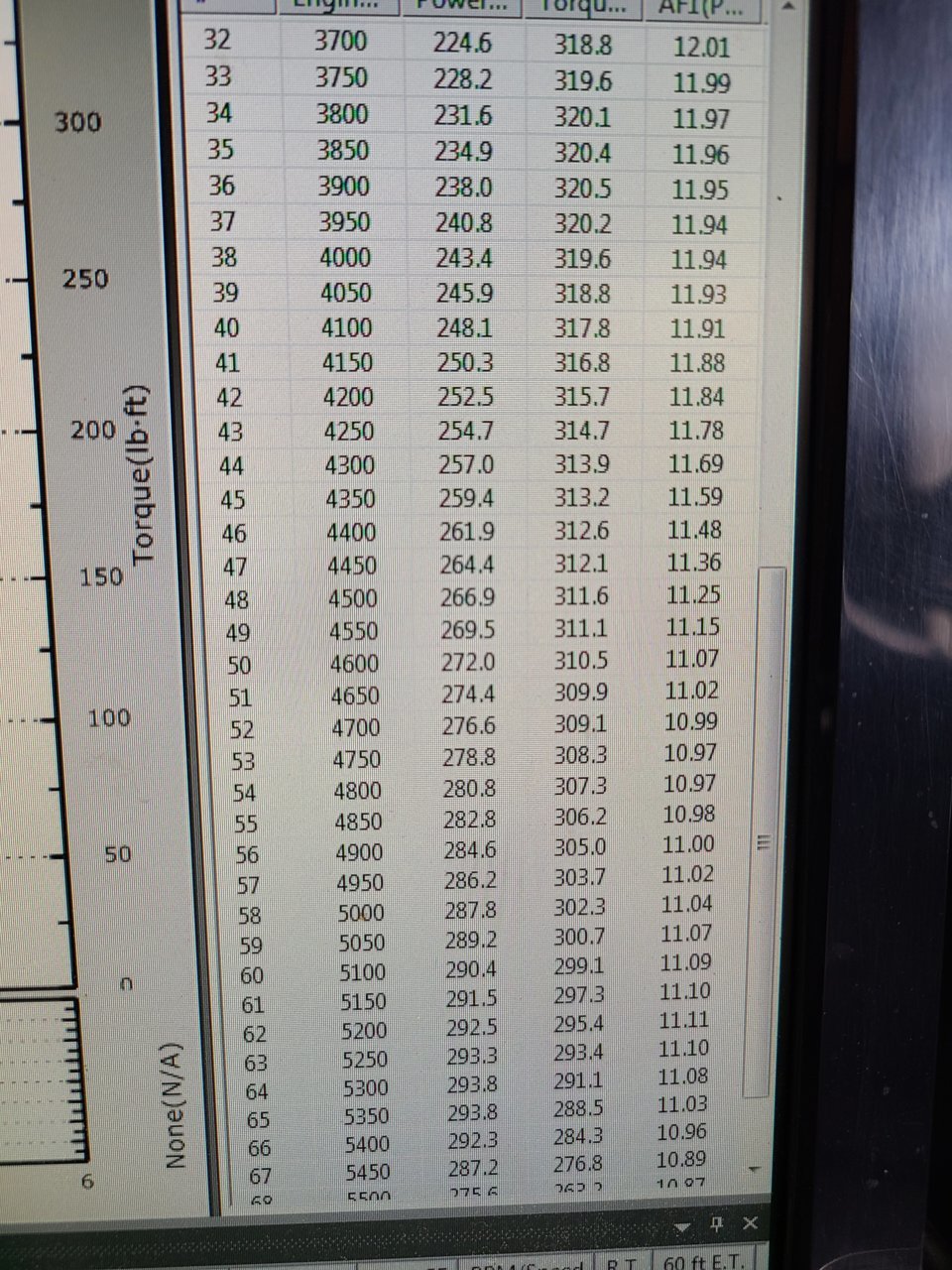

    Yeah there are some question marks about the general Dyno runs I got because ethe tech did not properly disengage the traction program. While he was calibrating the Dyno to do some pulls I saw the VSC light blinking but since the truck was moving well I didnt think it would be an issue. Justin indicates that the truck may had been cutting power due to this fact so I am going to try to get back in there tomorrow to make a few more runs if the owner lets me.

    Definitely do that. Yours should be higher than that. Even with a mustang dyno.

    I was pretty disappointed in seeing those numbers considering how powerful it feels otherwise. It definitely feels like it's a lot more than 300 wheel HP.

    Am I missing something though? this is on a 2.8” pulley right? So pulley is 1/8” less than stock. Stock 100,000 mile plus cats. And yes supporting mods, but mods that support the airflow that a 2.5” pulley and straight exhaust can produce.
    Honestly, for one step down in pulley size aNd a tune, that sounds pretty good.

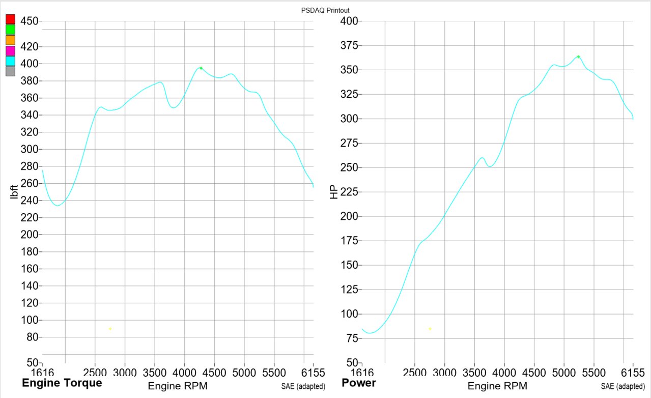

    Powermax 7psi final results.
    the big dip has been eliminated.
    The small dip in the middle is the ACIS valve. there is not way around that, it doesn't affect anything.
    results:
    340+ ft lbs available as early as 2500 rpm (although it comes on even earlier than this in higher gears).
    380 ft lbs at 3500 rpm
    395 ft lbs at 4200 RPM
    363HP at 5200 RPM
    Tested on 93 octane.
    ( I would deduct 5% from these numbers for 91)
    Torque converter full lock.
    With torque converter unlocked the dyno reads 380 ft lbs as early as 2300 RPM.
    there is no more noticeable power/torque dip / drop.
    For their 3rd Gen Twin Turbo kit.

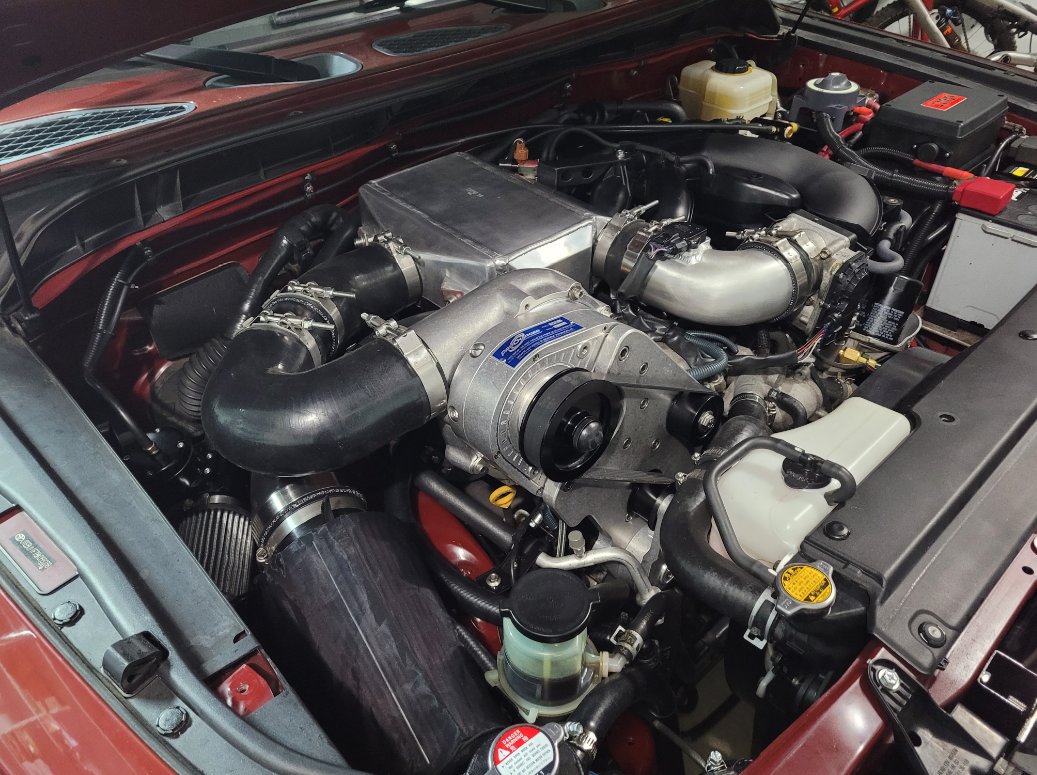

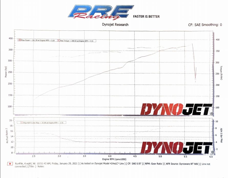

    2008 FJ
    Procharger w/ 3.6" pulley
    Homebrewed A/W intercooling
    FIC 525cc injectors
    AEM 340 fuel pump
    NGK 4904 .035
    URD Headers
    DT Y-pipe
    Custom 2.5" exhaust
    HP 381.99 @ 5.65
    TQ 368.92 @ 5.01
    10.08PSI @ 5.7

    nice! what size tires? FJ's making it happen.

    35's

    Nice to see what the Procharger can do.

    Yes it is! Thank you @PhoS

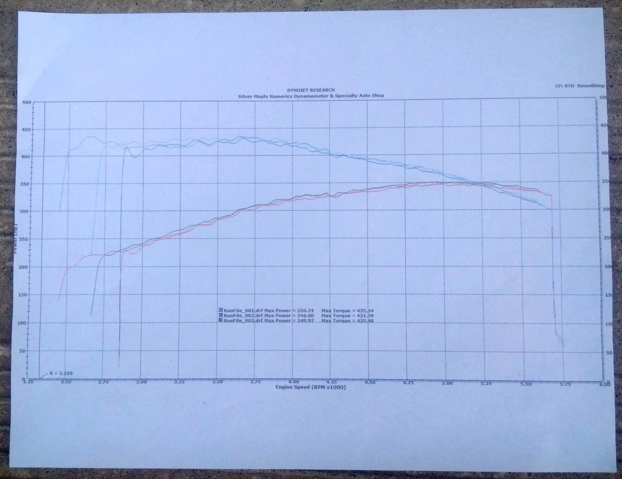

    2007 FJ Cruiser 6M/T
    • TRD Supercharger
    URD UCON-EMS
    • URD Spec-U LT Headers
    • URD 2.85” Pulley
    • homemade Equal Length Y-pipe
    356.3 HP/5767 rpm
    523.7 Nm/2658 rpm
    Boost 8 PSI

    Wow that looks pretty good. Is that at the rear tires?

    4wd dyno, calculated engine power.

    that torque.!!!

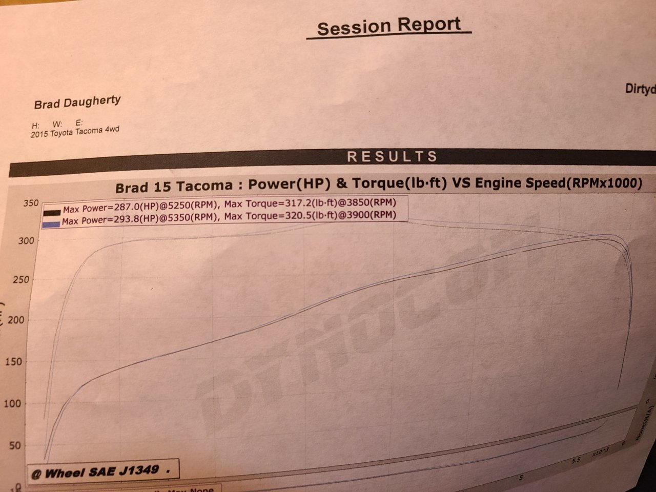

    2015 Tacoma sport 4×4 manual
    TRD supercharger/tune
    URD 2.85 stealth pulley
    Afe intake
    Afe headers w/ high flow cats
    Afe Y pipe
    Borla exhaust
    URD fuel pump upgrade
    Needle valve removed
    293.8 WHP and 320.5 WTQ @ 92° and 45% humidity.

    Not bad! Cant wait to get my header/Y done. Never did the needle valve but curious if that makes a big difference or not.

    Seems way more responsive to me. The delay I had with it in always annoyed me. Some people have apparently had issues after removing it so YMMV.
