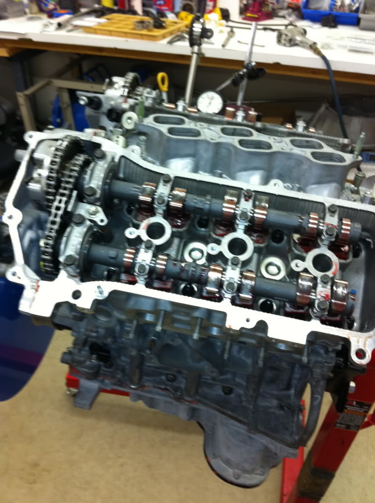

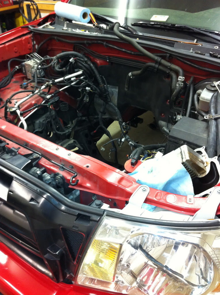

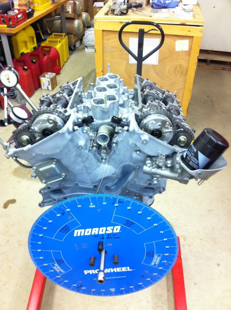

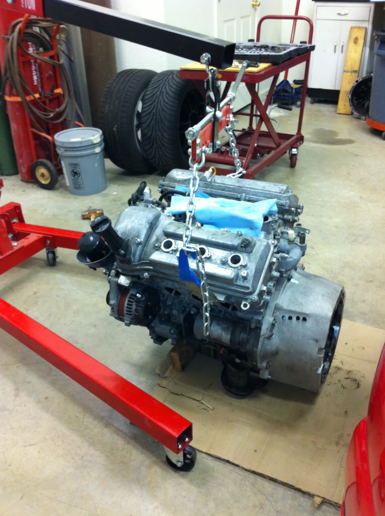

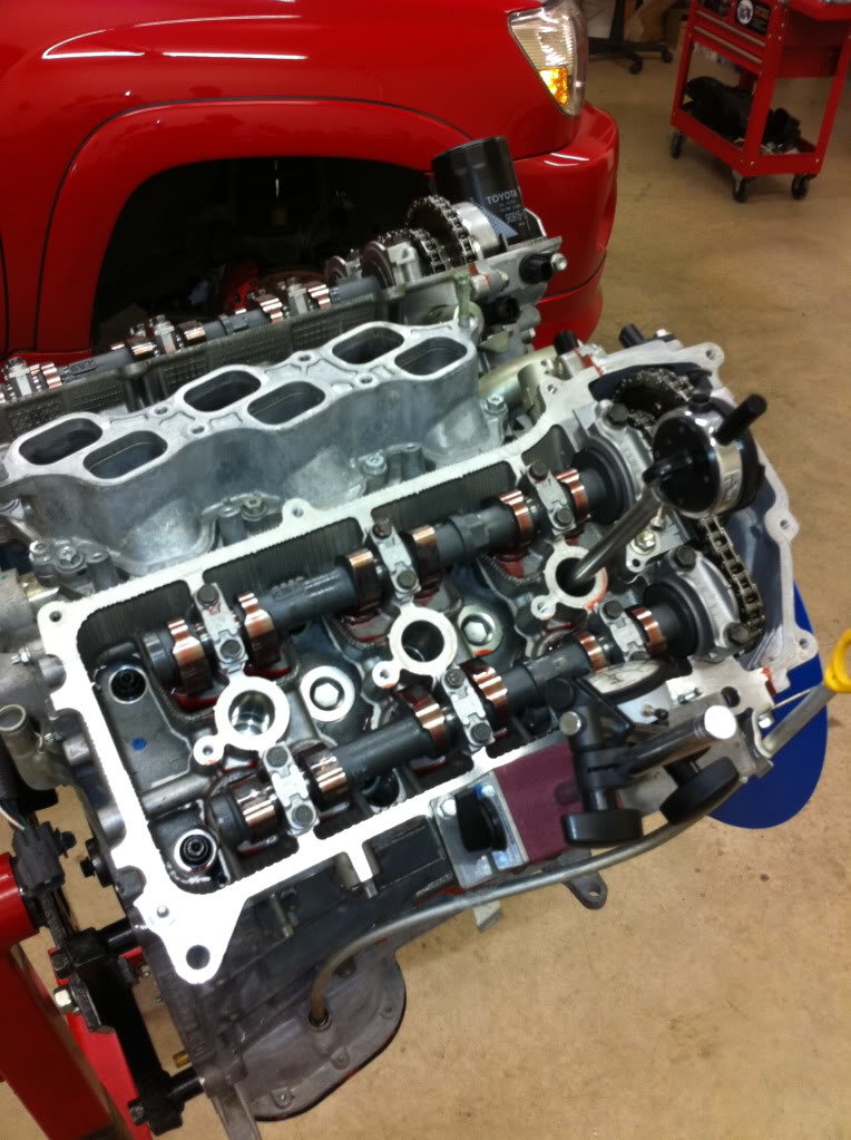

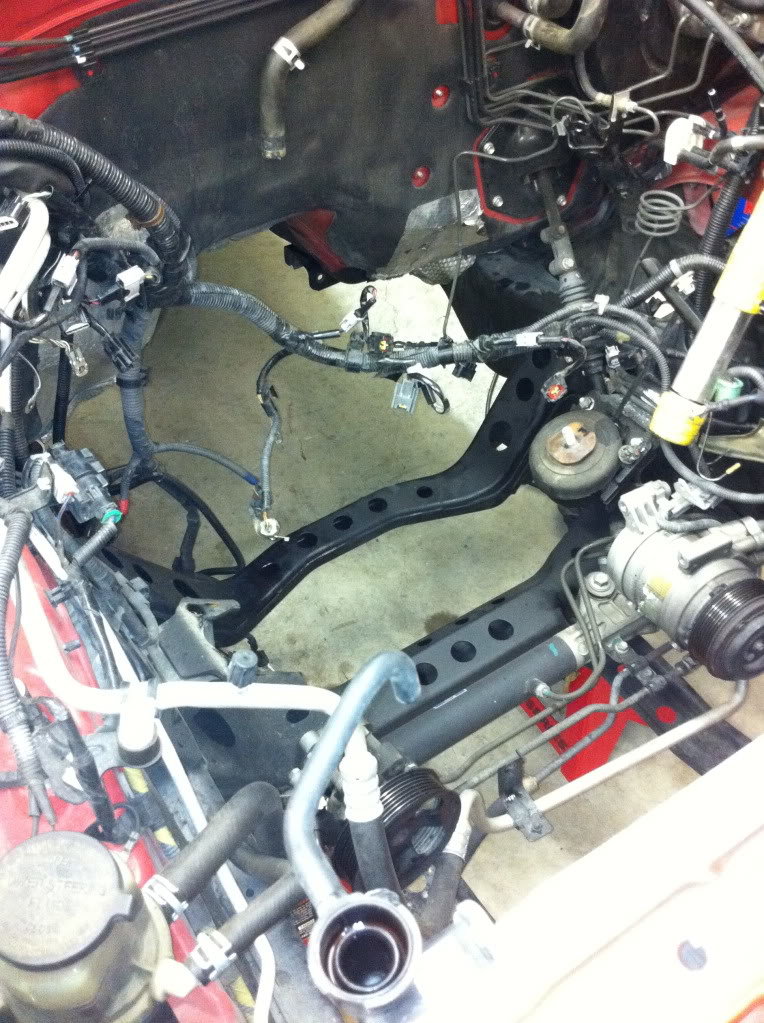

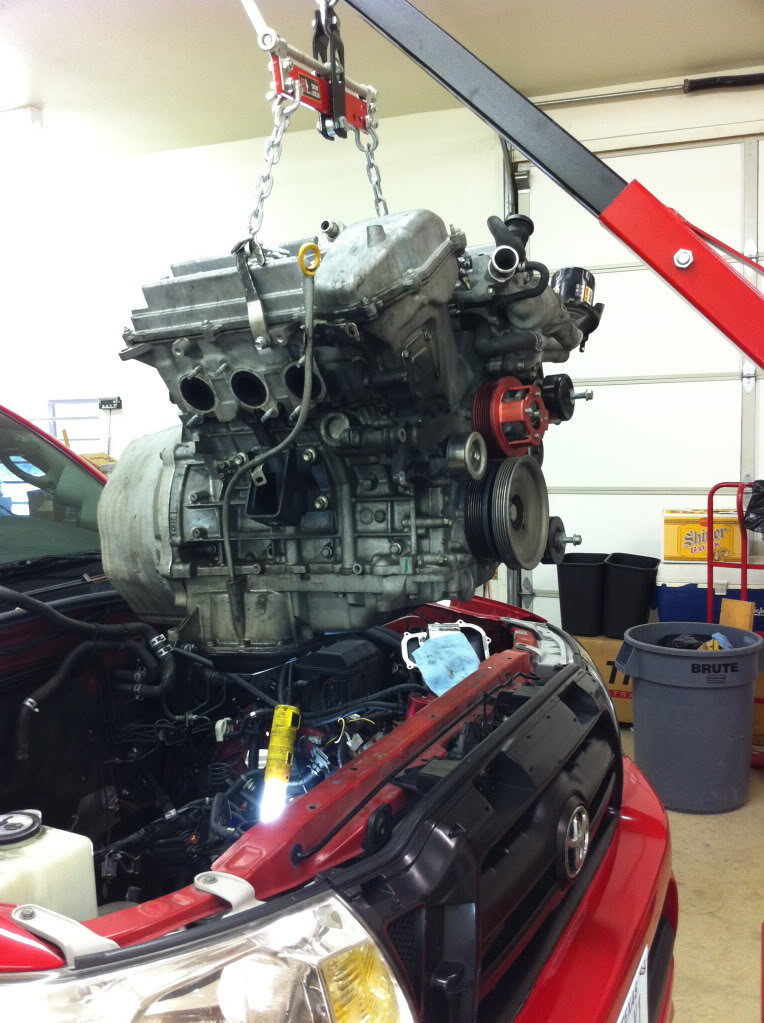

    Sorry guys that I have not done this sooner. Here are some pics and a nice nice sound clip of the new built engine. 21 months and done. The cams are a nice addition to this build. The extra $2000 is worth it.:proposetoast: One of the mods asked me why I have not done this thread yet so here we go.:sorry: The heads have been worked on for flow and stronger stiffer valve springs also. We are raising the rev limiter from 6200 to 6800 RPM. Stock was 5400 RPM. We are using the toyota head gaskets. Do not plan on running over 14-15 lbs. of boost so should be just fine. Crankshaft also has been smoothed out. Pauter Rods with JE pistons. Final cost on build will probably never be known. This build is not for the weak. HP goal is for right at 500HP and reliable. Remember I am running E85. The E85 is a beautiful addition. Roughly another 30-35 HP. I likey!! :D The first pic is a video. Just click on it and be sure to turn up the volume to hear it. th_IMG_0879_304f19e7f16b03c262aa1fd492aea3d6214acb6f.jpg IMG_0809_ca9c065f05f027285fb32a172e0fd230c0e470e7.jpg IMG_0808_9373cb06ee3b27b935fb32a897501cd6ee6365bd.jpg IMG_0807_9384771b3358d16dbd4aa9d3af913f44a8543584.jpg IMG_0803-1_fcf6b5dc0959001ded2b592122f13e811fb2efa0.jpg Here is a nice view of the cams. And to my knowledge the first XR boosted with cams. IMG_0802-1_04fbe9dda93749367f4845362b6137639e14c50b.jpg IMG_0801-1_d3427db0985c1b86d31bb67a56909f925824e86f.jpg IMG_0800_8622cf4e59554a464954be9bba78300d20ec2d4d.jpg Another mini video. Just click on pic. th_IMG_0798_aa9683444cc8da43eeae3d3722d732ee9f634313.jpg 791-919_49e5c1b47e296b4ff5414fe853f617c42e582efc.jpgThe last image is not for kiddies. :D:D:D:D:D:D:D:D:D:D:D:D

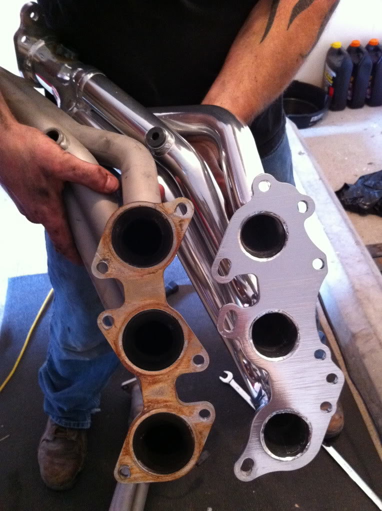

    Also would like to add that we have installed the new Doug Thorley headers and it gives it a deeper tone as well as performance. I believe URD has a group buy on these headers at the moment. IMG_0576_2cc0fc5e38e7e0c0605c871d3edecb814544d37c.jpg

    ........... I see you have a t56 swap bell housing..... So who are you really? Is this the infamous balboa?............... that first vid sounds like open y-pipe....... you might be the first boosted xr with cams..... but I don't know that for sure.... I doubt it with how many builds there have been for an xr..... also what CR are you running?........ what did you do to the block? (sleeves, closed deck?, etc) and you are only planning on pushing 500?..... that is a waste.... it's already been done..... It would be quite a disappointment if you didn't go for 600rwhp.... with that much work you should be able to easily achieve that..... what turbo set up are you running? Top mount? rear mount?..... there is so many questions to ask.

    I like yours. If we can swap engines real quick which I know we can you have a deal. :laughing:
