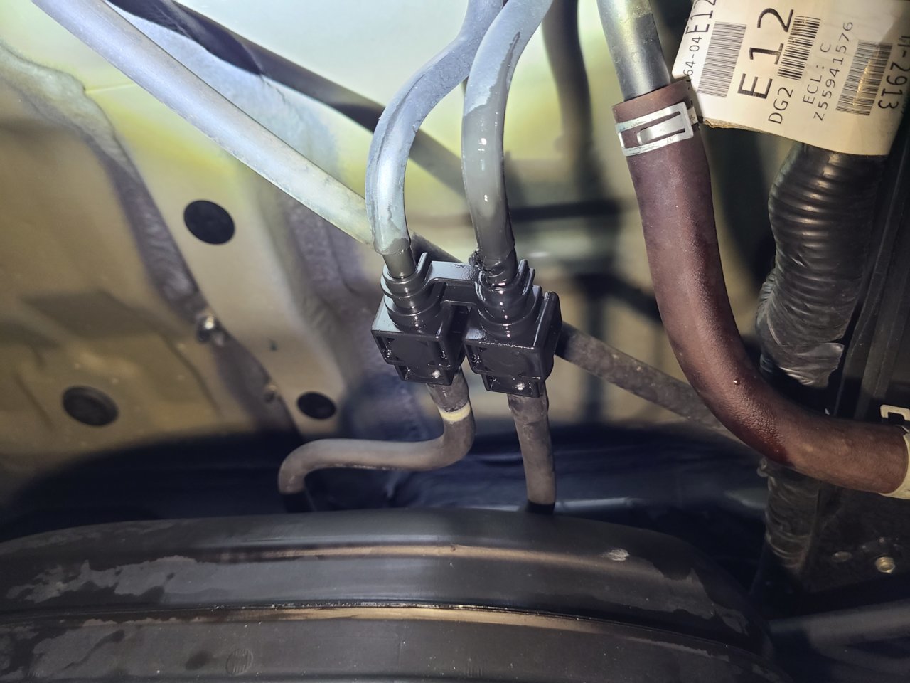

    My Tacoma started leaking fuel from the bottom line pictured. It seems the sleeve on the fuel line forward of the tank was wrinkled from whoever did the fuel pump TSB. My question is can I just peel back that sleeve and seat it back in this plastic junction? I really don't want to take it to the dealer and have them hold my truck or have my truck down but I also don't want a fuel leak. The hard line is steel and it seems just the coating is what's causing it not to seal.

    Yes I've seen that coating cause a fuel leak. (im a dealer tech)
    You can do it yourself but they caused the leak it should be fixed by them.
    Also did you remove the secondary locking cover? It goes over both fuel lines as a lock.

    Yes it unclipped very easily. So instead of replacing the whole entire line can I just remove the coating and reinstall it?

    Yup its what I've done.
    As a precaution for corrosion I spray a touch of undercoating on it. It's awful for the next person but it prevents any rust build up.

    PXL_20210728_023941095.jpgPXL_20210728_024224472.jpg PXL_20210728_035632003.jpg PXL_20210728_040109805.jpg
    10 minute fix in the parking lot. It worked! I'm going to coat that bare portion in the morning before I go to bed. Thanks y'all!

    I think I managed to stop the leak. I unscrewed the gas cap to depressurize the tank, disconnected the fuel line, peeled back the sleeve and then reconnected the fuel line. Everything seems to be fine, but I still plan to take the truck to the dealer because the problem shouldn't have happened in the first place.

    There is black plastic sleeve over the fuel line. See post #8. No need to replace the sleeve.

    My truck (2017) sat in the airport parking lot for 6 days and the it leaked fuel from this exact location the first time I drove it. It's never done that before. I cleaned the area thoroughly, inspected the connections for any obvious damage or corrosion, twisted the female connectors back and forth a few degrees (they won't move very much) and then reinstalled the clip that holds the lines in place and guards the quick connects. After a couple of trips, there are no more fuel leaks. This will be something to watch, especially the next time I have to park the truck for a while. I never had this problem on my 2010, which also sat for weeks without being used. I use name-brand fuel, so I'd be surprised if that's the cause. Probably the o-rings getting stiff with age (kind of like me :) ) and not sealing well if the pressure bleeds away over time then suddenly comes back when the truck is restarted after sitting for a week. I will say that there is no way the fault could be with the male, metal line, which is what goes up to the engine - so Toyota claiming this line needs to be replaced (as mentioned in a similar thread) is hogwash.
