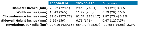

    You should take a look at the Tire Size Calculator if you haven't - You might find the size difference negligible.
    I had too many issues finding larger tires compatible with the Limited 18 inch wheels, and opted to get some wider 16 or 17 inch wheels.
    Luckily, I bought some 16" TRD beadlock-style wheels already mounted with 285/75 all terrain on Facebook marketplace for less than the price of the new tires alone - and managed to sell the Limited 18 wheels and tires on the same day. I'd bet you'd find a similar deal after a few weeks of hunting. Are you married to the 18" Limited wheels?
