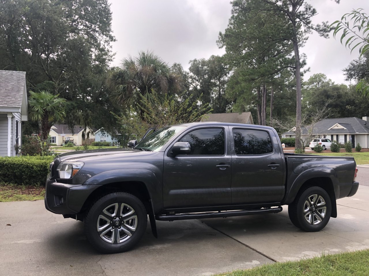

    Tires make more difference than wheels, a 20" wheel won't rub if you put small enough tires on them. How wide are your tires & how tall are they? Heck, give us the tire size & we can figure the measurements. Oh Yeah, they look pretty dang good. Please don't paint them black!!!!

    I’m just letting people know they fit. Since you know so much whatS the biggest size 18 inch tire I can put on without any rub? 265/60/18 are stock on the limited. I read I can put 265/65/18 on them

    No, I don't "so" much, just enough know the wheel size is mute & the tire size, that you didn't put in your first post, is the important part. The 265/60/18 is 30.5" dia. (tall) & 10.43" wide, the 265/65/18 is 31.5' dia. (tall) & 10.43" wide. 1" dia. ain't much on a tire, that means the larger 265/65/18 will be only 1/2" closer to the front of the wheel well & 1/2" closer to the rear of the wheel well. I never remember seeing a truck that won't take a tire only 1" larger than the orig. May put in the search area (top right of this page) largest tires for un-lifter 2015 Prerunner. I'd think the sizes should be the same for the Prerunner & the 4X4. Welcome to TW, look'in good, & good luck

    I put 255/70/18's on my Limited (stock wheels) - they are 32 inches and fit fine. With stock gearing your mileage will drop.

    Looks good, fills the wheel wells. Nice looking stock wheels.

    If you have a larger overall dia that is what lowers the final gearing ratio. You 'might' actually have a touch better MPG on interstate cruising that's pretty flat at legal speeds. Most folks loose MPG in town because the truck becomes sluggish with the gear change and extra weight. The performance hit for the off road crowd leads them to regear the diff. to compensate for the tires.
    Price a regear for your truck. Then figure how many years you'll need to get your ROI based on MPG. You won't like the answer, so you will be in the category of 'pay to play' with your new look.
    If you choose to black them out at least use plasti dip so they will be easy for the next owner to restore.
