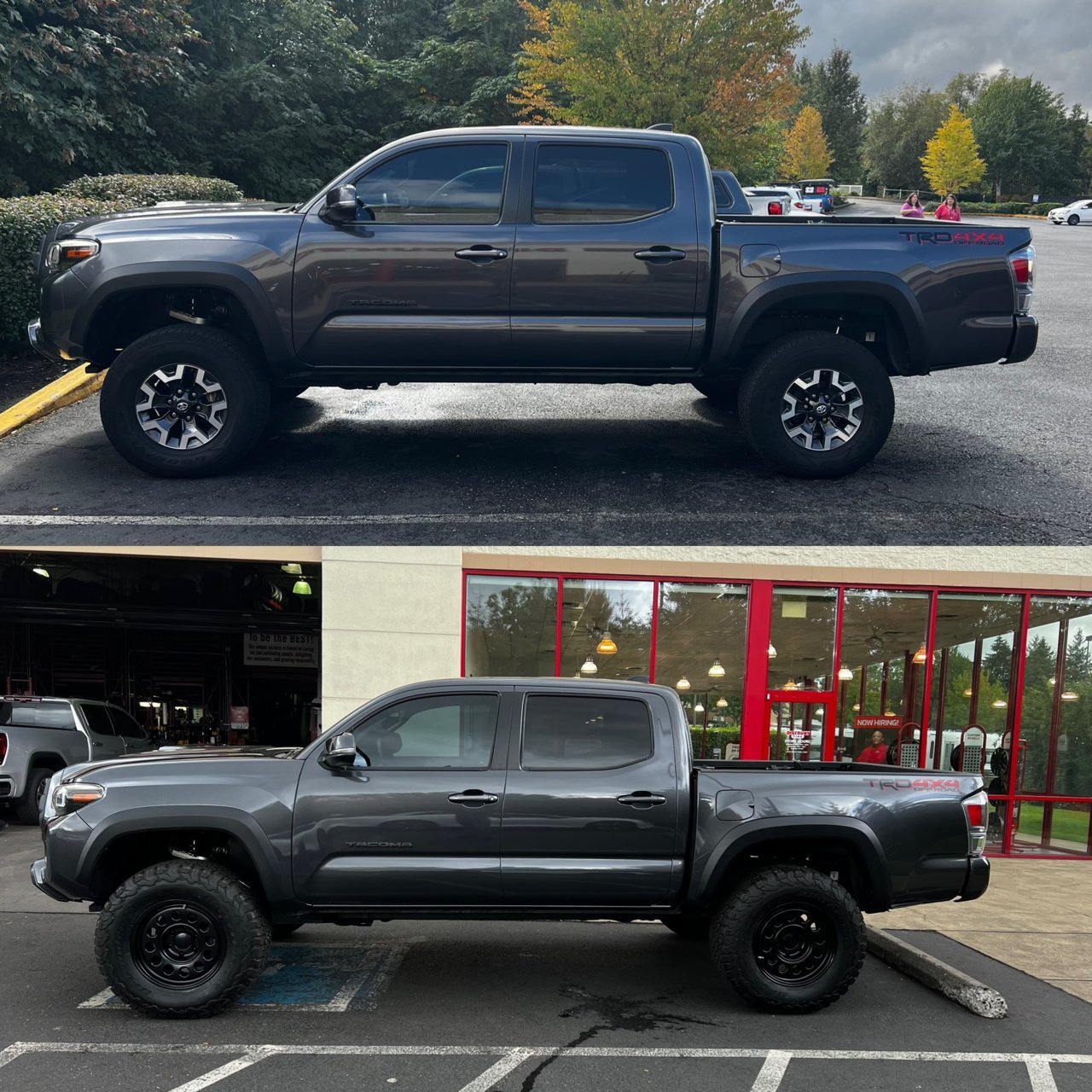

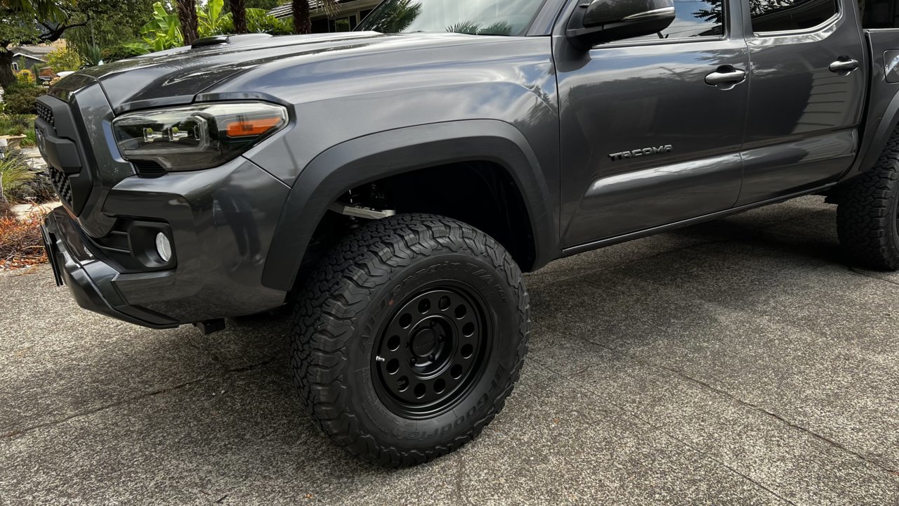

    Here’s before / after. I was STOKED to find a full user set of these BFG’s. The salesman said he knew the story on the tires and they only had ~50 miles on them. They look brand new.

  14. Sep 29, 2022 at 6:11 AM
    hilighter
    hilighter Master of Disaster
    Apr 12, 2022
    #394900
    247
    Portland, OR
    21 Tacoma MGM TRD OR DCSB ABCDEFG
    3” Ironman IM2.5 lift Body Armor stubby front bumper 10k Superwinch Ironman Raid rear bumper Custom sliders Nomad 501 17x8.5 Satin black wheels Smartcap Dashmat
    If those are actual TRD wheels I believe the offset is +4…Idk, maybe Toyota is making a 0 offset now though?
    Truck looks great! I love the look of the Nitto Ridge Grappler - it’s one of my favs.

    We agree, truck looks great, thank you for posting photos. Sounds like you found a needle in haystack on the tires, glad our store was able to take care of you.
