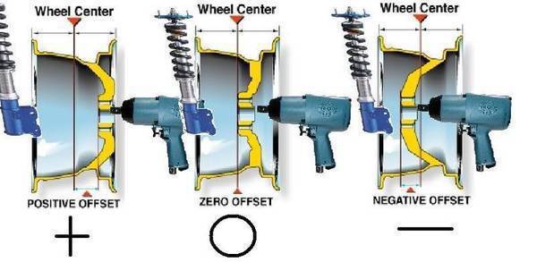

    Not a pro, but I think it's possible. BS may have nothing to do with it, it's the distance from the mounting surface (hub) to the spokes or whatever you want to call it. Usually arched, so as to clear the calipers.
    Measurements A, B and C below are a must.

    Offset would will help, but also the shape of the spoke surface ( from the inside). I would always check with the wheel maker for fitment before buying or try them if used. A local shop tried to sell me a set for the Tacoma, said they were a fit. I e-mailed Ultra Wheels and they warned me that that set would not clear the caliper. Some people may grind their caliper, but I sure don't recommend it, onced grinded the walls containing the brake fluid could start leaking under pessure.

    The viewing angle of the CAD design/drawing does make it a bit misleading. Here's a better picture of how it would look when mounting different offsets....
