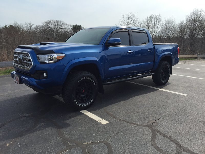

    Ok... to help my two friends above. I am a newbie as well and I went with the TRD Matte Black. I did 265/70/17 to guarantee no rubbing. I also went with a C rated tire (BFG KO2) as to not ride as rough. I could not be happier. Member Unchained5150 helped a ton, so I owe him a huge thanks. Here is a picture of my setup.20160515_144320.jpg

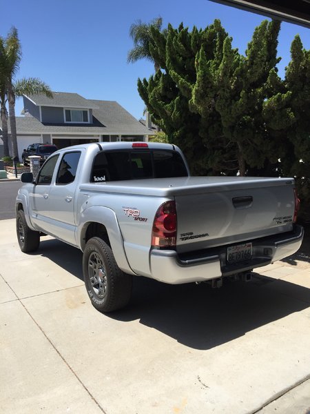

    Just got mine put on yesterday no lift and 265/65r17

    Looks awesome! Thanks for the confirmation on the fit.
