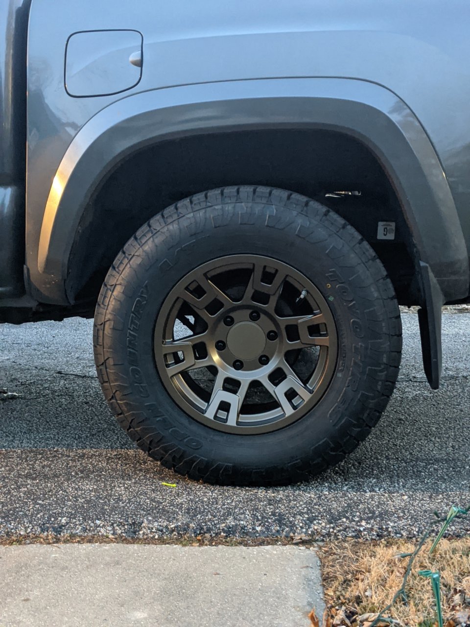

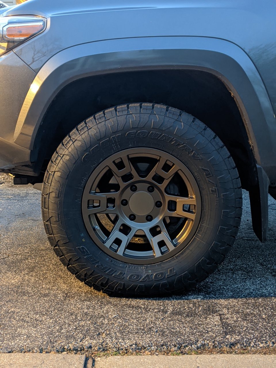

    With my birthday being mid December, Black Friday always seems like when I buy myself birthday presents. This year I did the wheels, tires and skid plate along with remote start. I'm still on the fence with the bronze wheels, but I took a chance. The installation facility told me that the staff was thinking the wheels did not look great, but by the time they were finished everyone was complimenting the look of truck. They even said the tires road better than any other All Terrain tire they have installed. We will see how it drives on the highway tomorrow, but through town I didn't notice much difference.
    I went with 17" FN FX Pro wheels. Dustin was amazing there by the way! They are 17x8 with 0 offset. The tires ended up being TOYO Open Country A/T III that are 265/70R17. I also got the black spline lug nuts from FN wheels and they are spot on in my opinion.

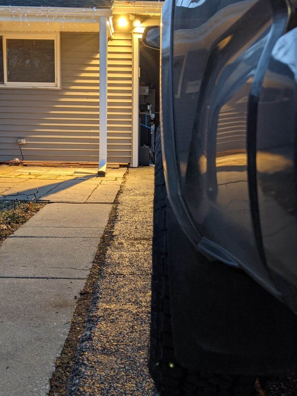

    The 0 offset is pretty much exactly what I wanted as far as tire poke. There is little to none so I won't be throwing debris up on the truck.

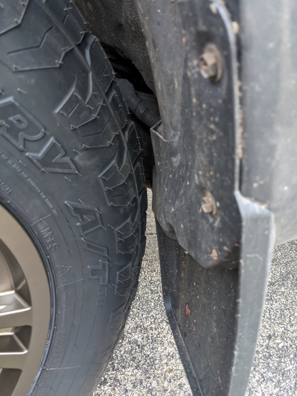

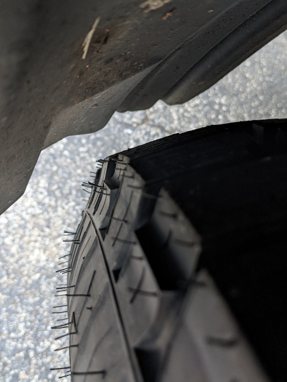

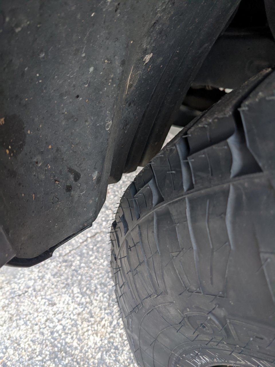

    The ONE AND ONLY issue that I may have is that turned at 3/4 turn the front tires are very close to the mud flaps. I've tried some bumps while turning and didn't feel/hear any rub, but it's a little too close for me and I may be looking at some minor mods to give some more space for suspension travel.

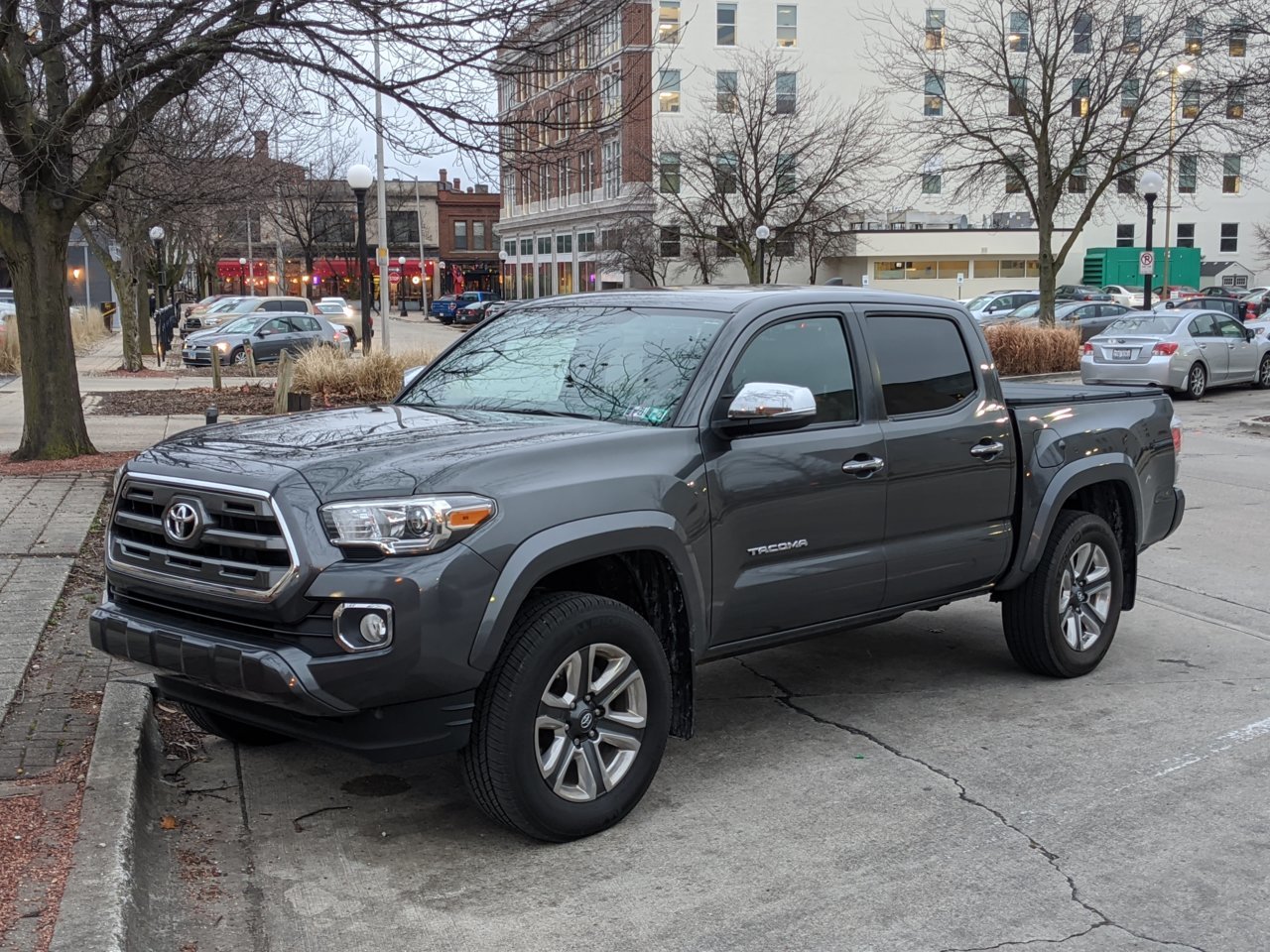

    From what the truck started with (18 x 6.5 factory Limited Wheels, spalsh guard and air dam) to where it looks now is a big change for me and I'm pretty happy with things so far.
    Future things I'm going to look into:
    1. The front mudflap "almost rub."
    This may be as simple as pulling the mudflaps, but I'm going to try to avoid that.

    Looks great IMO. Maybe some TRD centercaps and you can also install flatter aftermarket mud flaps that will clear that size tire easy. I have the same setup basically and it clears.

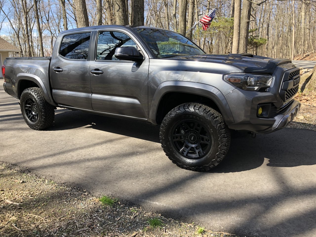

    Looks great. I was debating bronze on my MGM also but in the end I think Dustin had black only in stock at the time and I didn’t feel like waiting.
    I ended up getting decals for the center caps and I like them so far..a vendor here I believe

    After taking off the front mudflaps I have really limited any rubbing to situations with a 3/4 turn and hitting a bump at more than 10 mph. It doesn't happen very often, but I know my driving, so...
    INO: Going with a postive offset will not help unless you get it way out there. If you look at my pictures, when the wheel is at 3/4 turn the inside portion is closest on the rear side which is why I removed the mudflaps.
