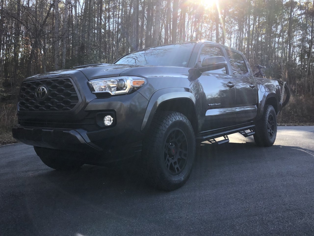

    ...i'm dumb. I just made the assumption when they added the "XP Predator Package" that they did this to the specs on the website builder...it looks as though they did not, which makes sense somewhat as the dealer had the truck on lot and told me they could add the components of the package at a reduced price (I thought this was to move the truck, and it may have been...).
    It looks like, using a tape measure...something I probably should have done before embarrassing myself with this post...that the rim diameter is 17". I'm assuming this means they likely added the Sema TRD Pro wheels from a 4Runner?

    Yep. Can post a picture if you want definite confirmation. But likely yes.
    I think those look better anyway.

  17. Dec 22, 2019 at 6:01 AM
    #17
    btrumpatori
    btrumpatori [OP] Well-Known Member
    Nov 27, 2019
    #311901
    102
    Thanks! I agree - I think they look great.
