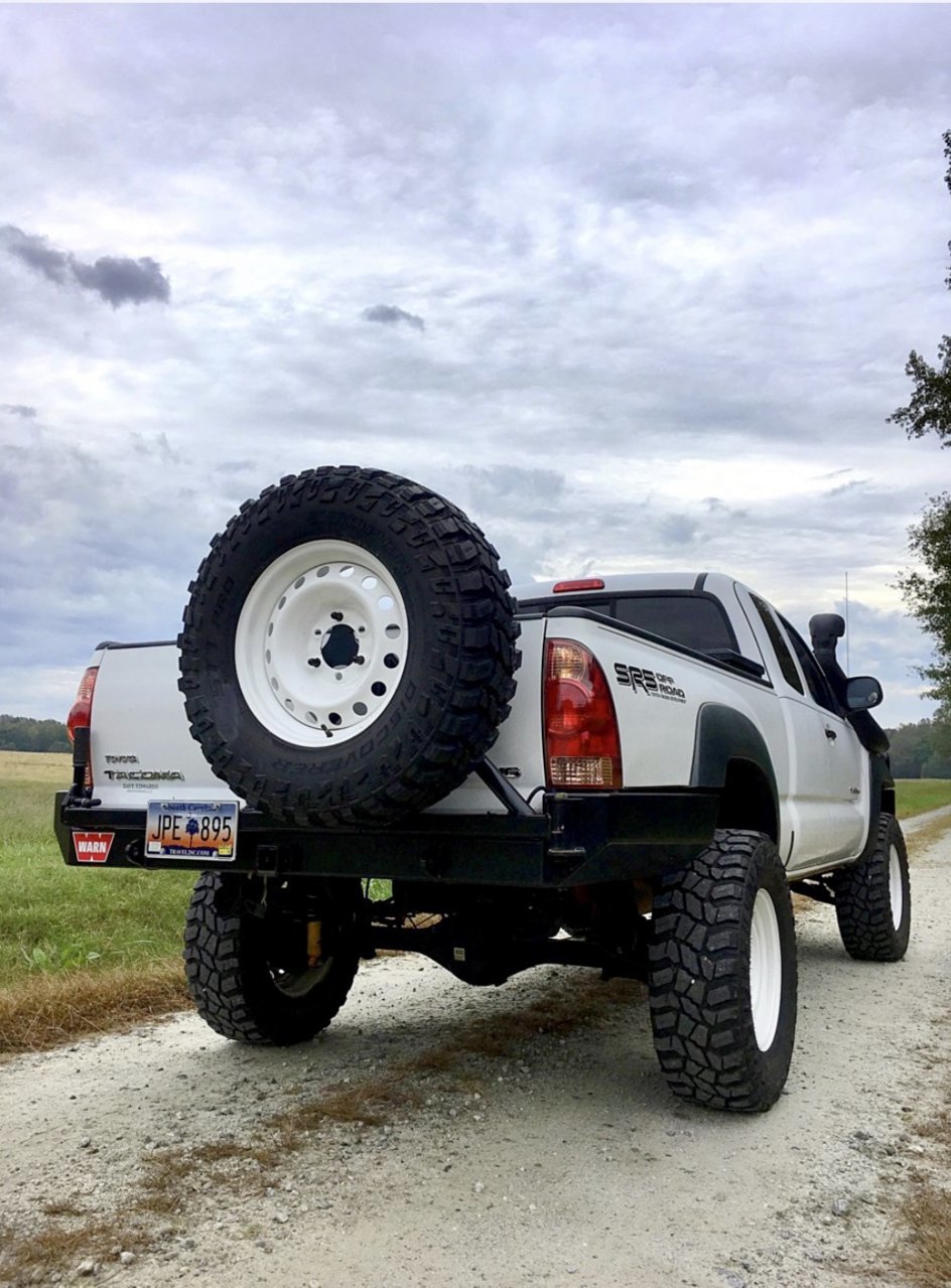

    Not the best photo but these are 16” steelies off Amazon. They’re nice, solid and balanced easily with km2s. Mounted up with no issues.

    Nice set up Matt. I Ran them for a couple years. 0AC3D053-20B6-4220-9252-93557BA1CD87.jpgRecently went bAck to factory alloys. The steel wheels are heavy and my mpg have increased since. 5B5782B4-51AF-4E79-B0CF-986746289505.jpg

    Those steelies in posts #2 & #3 appear to be factory wheels, same as my 2005 TRD OffRoad spare.
    If so, you might find 'em in salvage yards, probably came as factory spares on various Tacoma models.

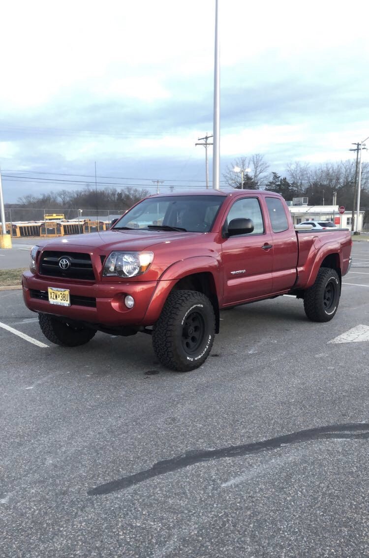

    I decided to go the alloy route. Originally wanted to go steel because of the price, but i got these off 4WP for under $100 a piece. Went with the Pro comp 7069, 16x8, 4in backspace, -12 mm offset. They fit! Cleared the caliper by a hair. Kept my 265/75r16 KO2’s. Ride and handling is noticeably better
