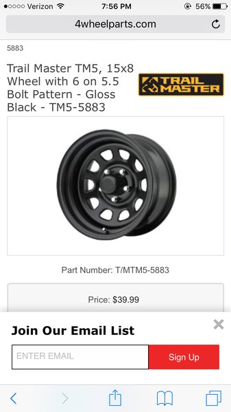

    so I was about to order the trail master tm5-5883 steelies for my 02 Tacoma when the guy called me from the store and said they would fit. I was gonna by 15x8 inch and he said that there's not enough spacing and it will hit my caliper before bolting all the way on and I will have to run spacers. Also he said that the 15 inch wheel hub would not fit around my caliper and I would have rubbing. They have 3.75" back spacing and I'm just wondering what you guys think? Does anyone have these rims on a 02 Tacoma if so did they work?

    I know people on here have run 15x8s no problem. I think it will work fine. If you have a local wheel or tire shop see of they can test fit a 15x8 on your truck and see in person if one will really fit.

    My 15x8 fits fine :thumbsup:

    https://www.summitracing.com/parts/vsw-84h5883ns/overview/
    And before they were 'vision' rims they were Summit's in-house brand is my assumption because they look/act the same, anyway.
    on my 2003 Ltd Tacoma, i did have to shave the front calipers and have had no issues. -or- i could have run those 1/4" spacers but didn't want to. Not sure how your aluminum rims will differ from the steelies so of course YMMV.
