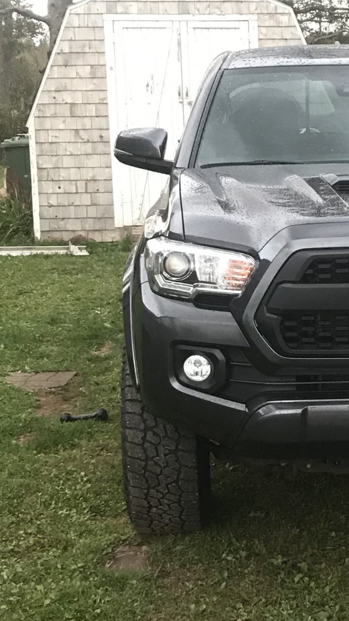

    I’m running 265/70/17, 17x8 wheel with +5mm offset and it’s pretty well flush. I can get a picture this evening.
    Couple crops, to get an idea.
