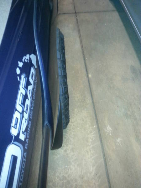

  20. Mar 25, 2015 at 4:08 PM
    #20
    zboy
    zboy Well-Known Member
    Jan 26, 2013
    #96197
    586
    Oahu808
    12 TRD OR
    16x8 4.5 BS 1mm OS with 265/75/16 tires [​IMG]
