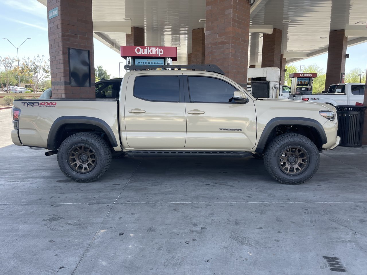

    Im working completely backwards from you haha. On my last Tacoma I went straight for the eibach pro kit and loved it, just traded that truck in last week and took all my parts except the lift.
    So with just buying a new truck my wife said I can’t immediately buy a lift so I threw in a 1/2” top hat spacer and 1” rear block.

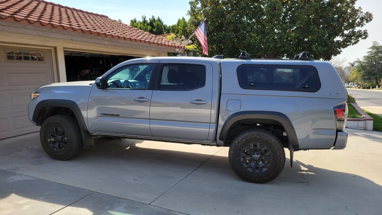

    Here is mine with just the street rays spacer on the front.

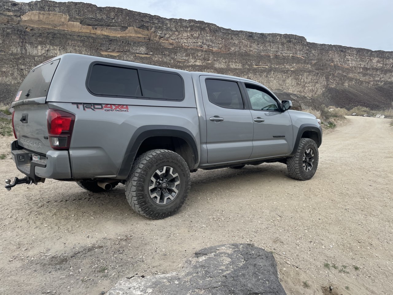

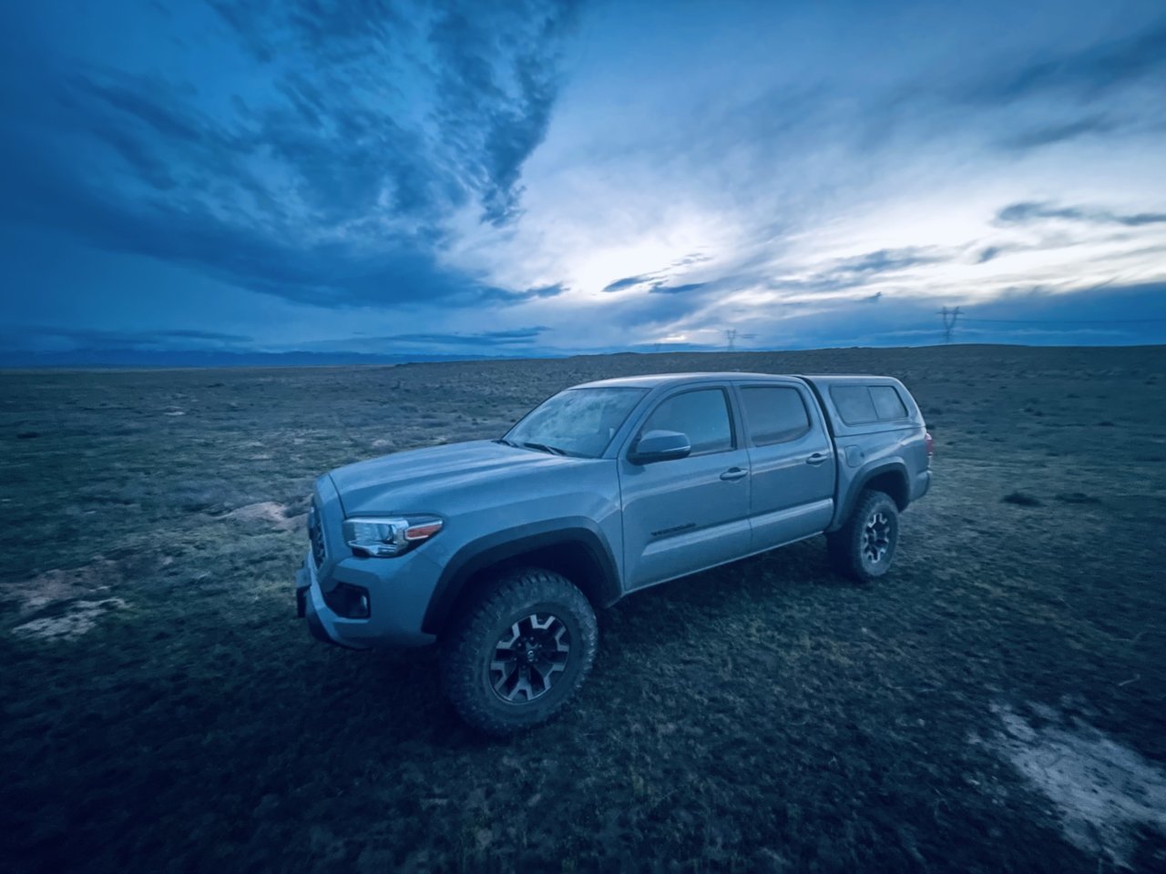

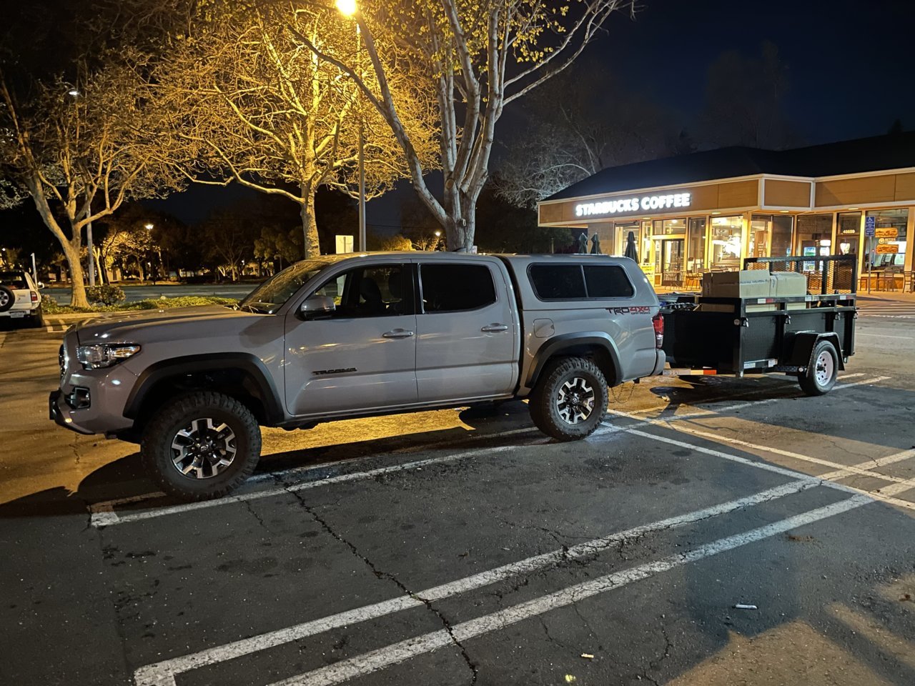

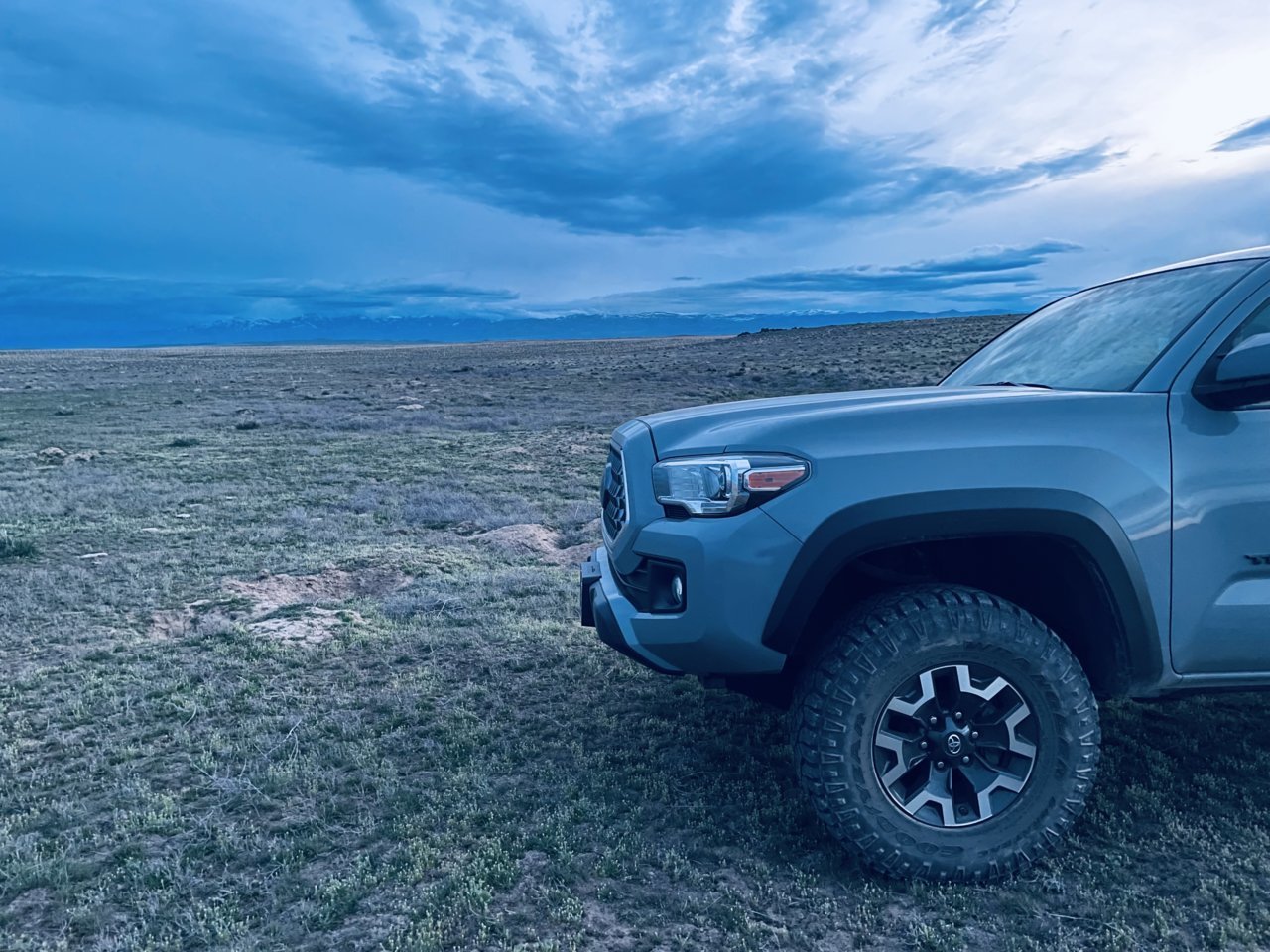

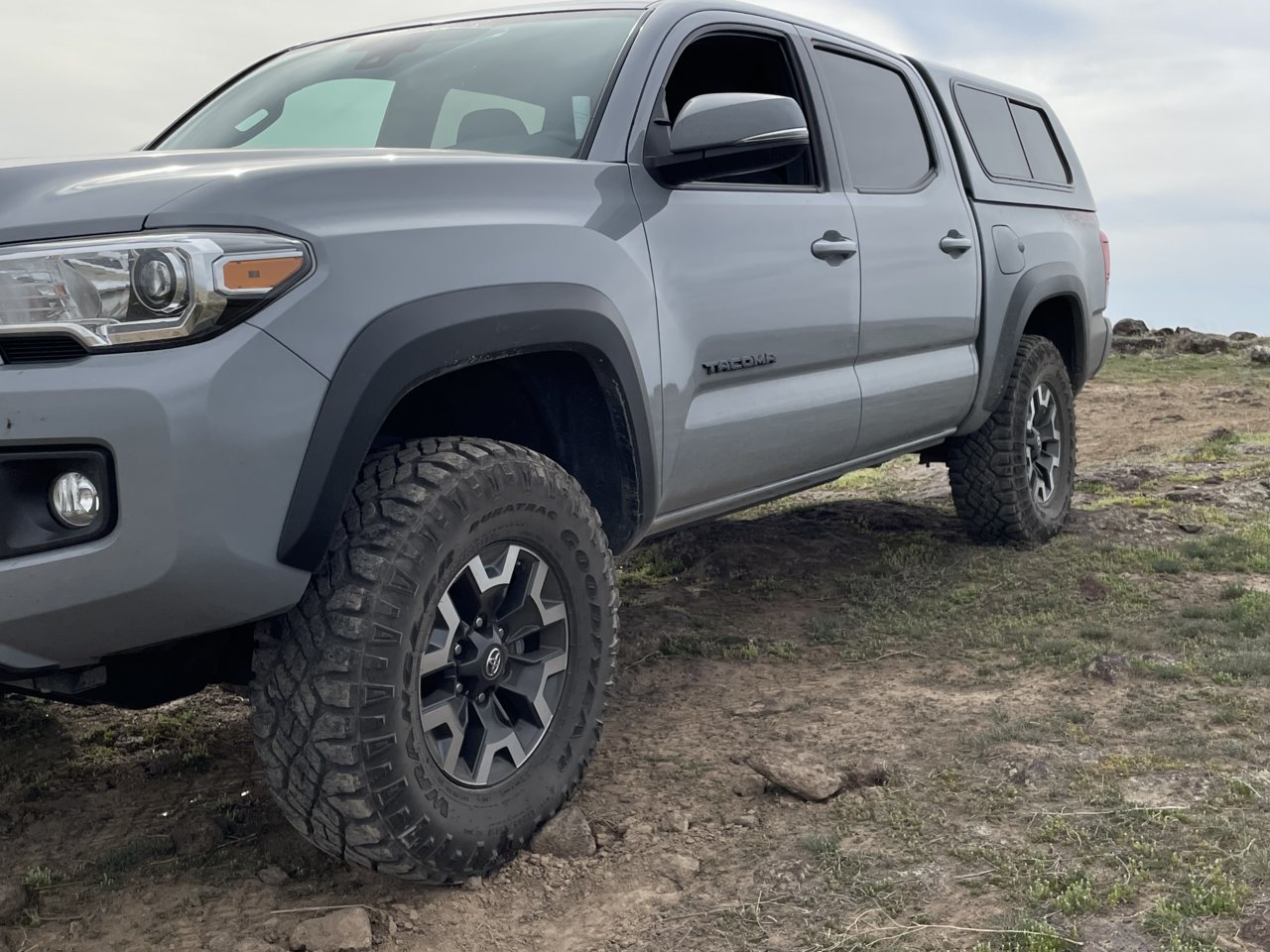

    Just a Snug Top with Sportsman’s package 1 inch lift and 265/75-16 Duratracs.
    I went through all this months ago, you should be able to find the thread somewhere but the long and short of it is a .5 spacer up front is no problem. Outback I happen to add a 1 3/8 spacer or something like that because my topper and I always carry some gear. I’ve wheeled my truck and done tons of back country exploring with no issues. I also loaded my bed completely full and towed several thousand pounds when I moved. It worked out great, I’m very happy with the results and the truck drives stock. I also had zero issues with the alignment. I have a few random photos from my recent trips over the last month but if you want better comparative photos then find that thread. It’s probably on my post history but honestly don’t waste your time. Get the .5 front spacer and 1 inch rear blocks, done.
    Good luck!
