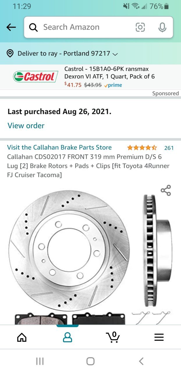

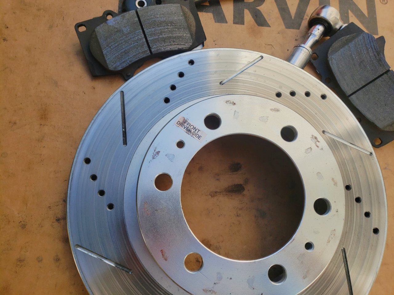

    Thank you for the many responses. I have about 2mi on them. Removed LH and checked. Metal dust on the spindle, probably to be expected. A screen shot of product and the light scratching on pads n rotors. Does make a pretty loud chattering just before complete stop, F n R. 4WD btw. Makes me nervous but all was/ is tight upon reopening the can of worms. The pad pic. That is LH and that clip is on inside and on the bottom. Should it be on top inside?
