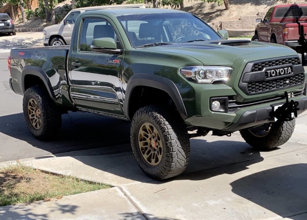

    The bed is cool.... the front end is caca

    There is a guy on the X-Runner Facebook group that has done a full 3rd gen conversion, making himself the only 3rd gen X-Runner out there. It is still a work in progress but it is pretty interesting looking.
    There is something like a 3" difference in fender height between a 2nd and 3rd gen so the transition on the A pillar is a challenge. And I think the body line in the lower part of the door/fender area is different, even though it is in the same place is totally different.
