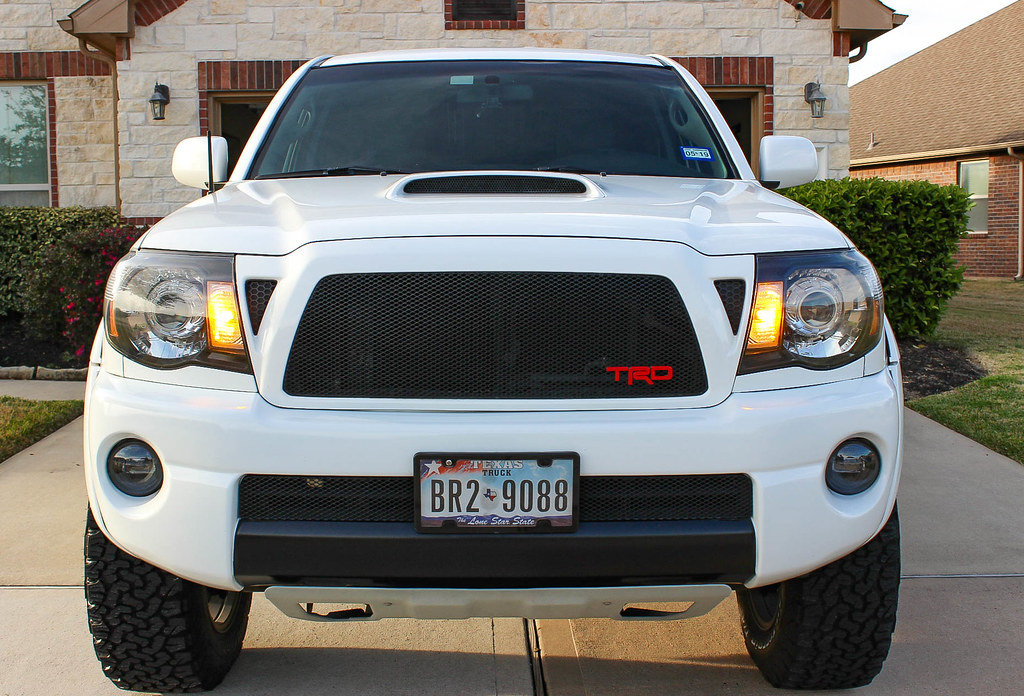

    TRD Baja Suspension, FN Wheels BFD, TRD Cat-back Exhaust, TRD Cold Air Intake, TRD GrillCraft MX Grilles, FX-R 3.0 Bi-Xenon Retrofit with Osram CBI Bulbs, OEM Navigation/Bluetooth/Backup Camera Retrofit, WeatherTech Floorliners, Valentine One, ScanGuage II with custom V1/SGII BlendMount

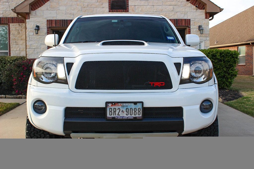

    I used the VLEDs V6 Triton Switchback LED bulb:
    https://www.vleds.com/shop-products/v6-triton.html
    they’re pricey, but extremely bright and quality product.
  16. Feb 14, 2020 at 1:04 PM
    #76
    LoLo1417
    LoLo1417 Well-Known Member
    Aug 11, 2015
    #161514
    65
    2013 Tacoma TRD off road
    Did I look up the right light? $125 for turnsignal DRLs? It seems a bit extreme. Are they plug and play? Or am I still splicing wires (I saw built in load resistors) anyway to do this for a little less? Like around $65 I like keeping my baby a quality build but I’m saving for sliders from smelmepoo rn so this seems a bit steep.
    steveh_2007 likes this.

    No splicing required. Completely plug and play and no hyperflash. I used these in my OEM headlight projector retrofit housings on my 2007 before I sold it. If you want the best with a 3 year warranty, that’s how much they are... good luck.

    I kept buying the chinese brands and Amazon stuff before finally getting VLEDs and haven't looked back since. Never an issue with hyperflash or a bulb partially being burnt out. Should've done this from day 1.
