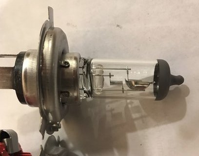

    This picture was taken prior to aligning my headlights. They were pointing high left. Also, my lights have little cracks in them, which disperses a small amount of light. It does it with halogens or LEDs.
    After the alignment, both halogen and LED has the EXACT beam. I bought the W Series because they have a reflector as the same in halogens.
    Take a look below.
    Mine (LED) with reflector:
    LED without reflector (cheaper):
    Halogen with reflector:
    Only one LED diode illuminates on low beam (with reflector). The other then illuminates what the high beams are activated (to create brighter and higher light).
    Same thing as your halogens. You can see two separate filaments. One with a reflector and one without.

    Many LEDs are 'designed to work like a halogen' but that doesn't mean they actually end up working like a halogen. Since there are currently no SAE compliance standards or any standards at all for these products, it is very much the wild west with these products with ridiculous amounts of low quality poorly designed China garbage flooding the market, like the Auxbeam lights posted above. However, there is a science for how to make these products perform better than some others and they seem to understand this better than most. LEDs must exactly replicate the X and Y coordinates in size and position of a halogen filament, and critically the distance between the opposing LED faces must be as small as possible, the same width of a halogen filament in order to have focus which is needed for distance projection. And that last one poses a challenge to most LED companies, as either they cannot build it or don't understand it. You can see some extensive testing in my 3rd Gen thread about the focus issue where projectors rule out glare issues.
    https://www.tacomaworld.com/threads/3rd-gen-hid-vs-led-vs-halogen-h11-projector-headlights.589465/
    DD does not offer an dual filament H4 product like is required for 2nd Gens, so asking them for headlights on an 07 is a bit of a non-starter. I'll will be testing the DD LEDs in my 3rd Gen thread to see how focus and distance projection compares to halgoen. But again, glare isn't an issue with the 3rd Gen due to the projectors, however loss of focus and resulting loss of distance projection has been a significant problem for LEDs. It will be interesting to see what the data says.
    I'm not trying to pick on you, really! But the projectors do not focus light for you, that is a common mis-conception that just because it is a projector means you can throw anything in there and it will focus the light correctly. The only advantage of a projector is that is has an internal glare shield which cleans up the glare from bad light sources, however with LEDs you still usually end up with loss of focus resulting in loss of distance projection as covered in detail in this thread: https://www.tacomaworld.com/threads/3rd-gen-hid-vs-led-vs-halogen-h11-projector-headlights.589465/
    Yes, your AuxBeam LEDs have a low beam glare guard, the Opt7s you pictured from one of my other threads do not, which predictably results in a disaster of a beam pattern. The Opt7s were chosen for that thread because at the time they were a front running favorite LED on the forum that many recommended with great reviews, when it was very clear looking at the product that it would not work. I've tried several other H4 LEDs that include low beam glare guards and are a far more advanced design than those Auxbeams, and they still produce significant glare, there are numerous updates in that thread aside from just the oldest Opt7 LEDs without the glare guards used to make the initial thread.
    However, even with low beam glare guards it is not possible for those AuxBeam lights to work correctly or have the same pattern as stock, you can tell just by looking at the product. The LED in no way replicates a halogen filament, that design will cause glare, loss of focus and loss of distance projection. Look at the Diode Dynamics LEDs pictured further up in this thread, the LEDs are in the exact shape of a filament. Those AuxBeam lights are a using a very dated square chip with a circle emitter. The LEDs must be oblong in shape in the same dimensions of a halogen filament, not just circle emitters placed in the approximate position, the lighting geometry is completely incorrect.
    Looking at the last head on photo of your truck, you can tell the lights are not working properly. You have a pretty bad V shape above the bulb which will reduce beam saturation, but most importantly the glare guards are not working and you have light entering the lower portion of the headlight which is part of the high beam reflectors, meaning they will produce significant glare. On low beam the headlights should only be illuminated in the upper part of the housing with a very sharp flat horizontal cut off at the level of the bulb and higher, no light should enter the lower portion of the headlight assembly. Not only do you have light hitting the high beam area of the headlight, you have no flat horizontal illumination cut off, which is clear evidence the glare guards are not working.
    Another common notion is you can 'adjust your headlights down to fix glare with LEDs'. It doesn't work that way, glare is light escaping above the designed cut off, aiming your headlights down doesn't fix light above the cut off and significantly reduces your distance projection, which is the main purpose of the headlight. Unfortunately the loss of focus also causes the light pattern to shift toward the vehicle with significant foreground light, further reducing distance projection and vision. So you end up with a blob of light immediately in-front of your truck which many initially think is an upgrade as people psychologically intrinsically like foreground light, but then later driving at speed down a dark road, many realize that with their "upgraded headlights" they actually cannot see very far at all.
    Driving at night with those lights, you will notice street signs on the side of the road that are above your headlight light cut off light up like they are radio active, as well as overhead highway signs, and that is your introduced glare.
