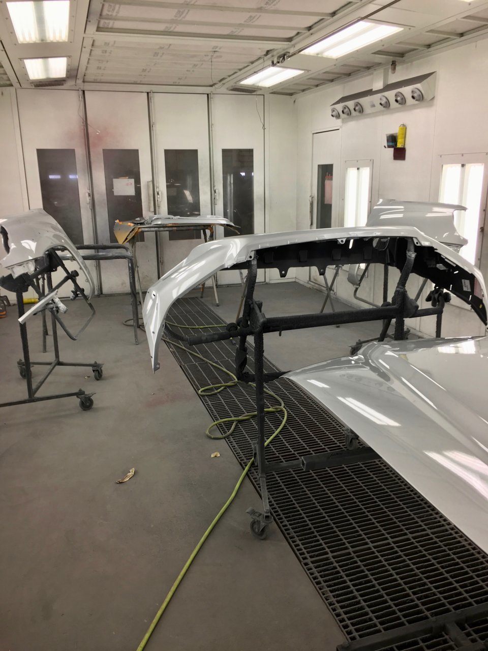

    Your fenders do NOT need to be replaced, the design is exactly the same 2005-2015. The only painted panels will be bumper/bumper flares, hood/hood scoop, plastic fillers below headlights, and grille surround trim.

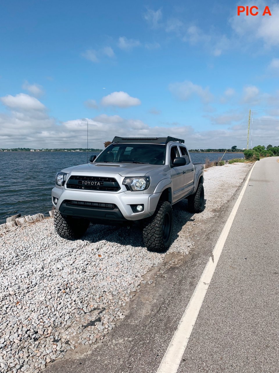

    Blackout OEM Style Headlights - (Seen In PIC A)

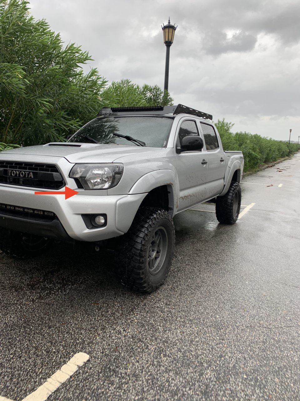

    Headlights Installed On My Truck -
    TRD Pro OEM Grille Insert -
    LEFT & RIGHT Fender Wheel Liners - (If you want the fender liners to fit to the bumper properly you will need these)

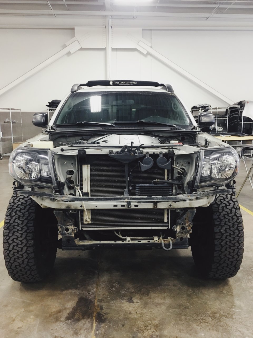

    In Process:

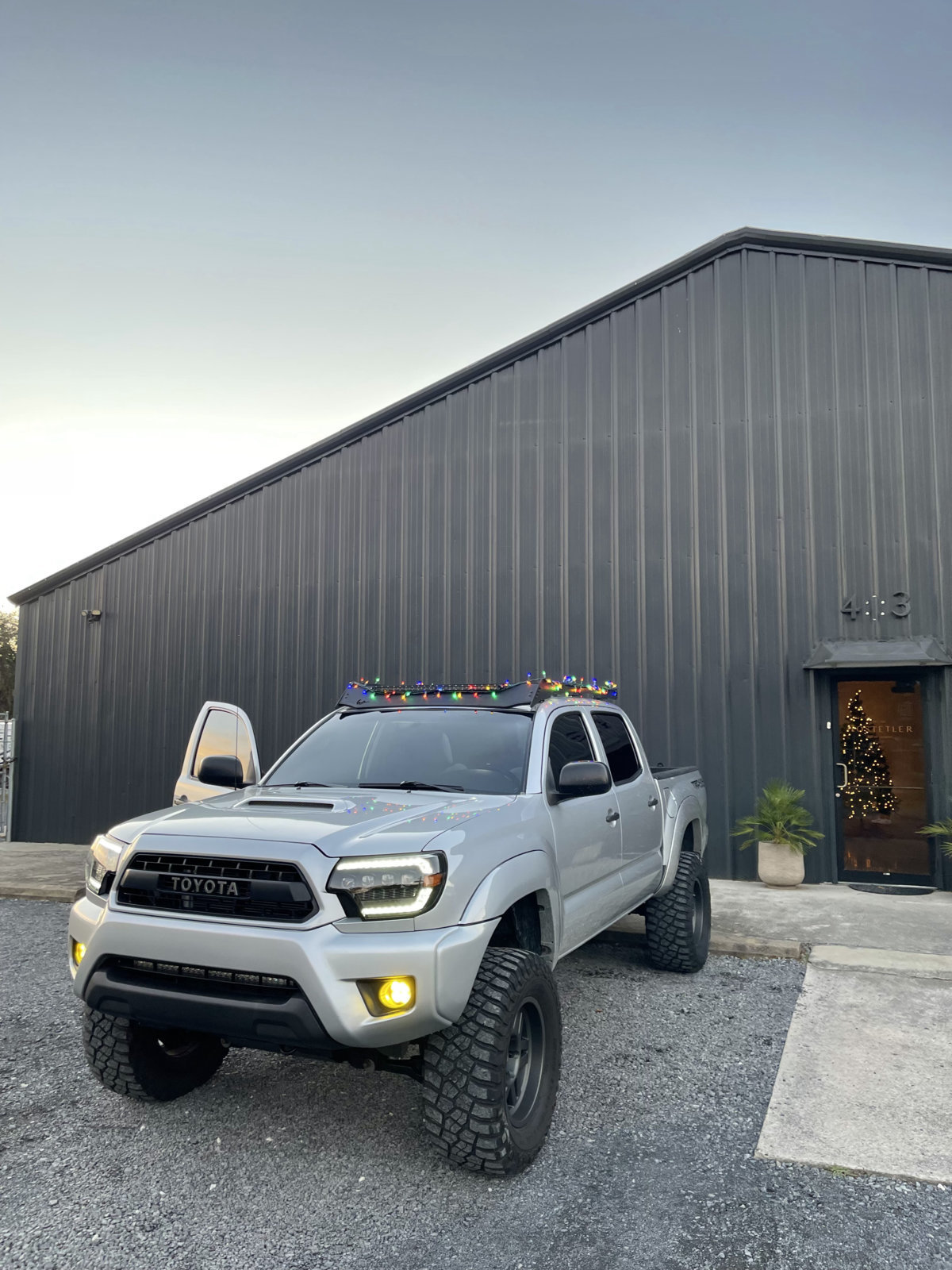

    After:
    Update 5 years later,
    I am indeed still happy I spent the $$ and converted the face, I enjoy the better looking less bubbly front end. Also just crossed 250,000 miles and hope to drive it another 100k at least!

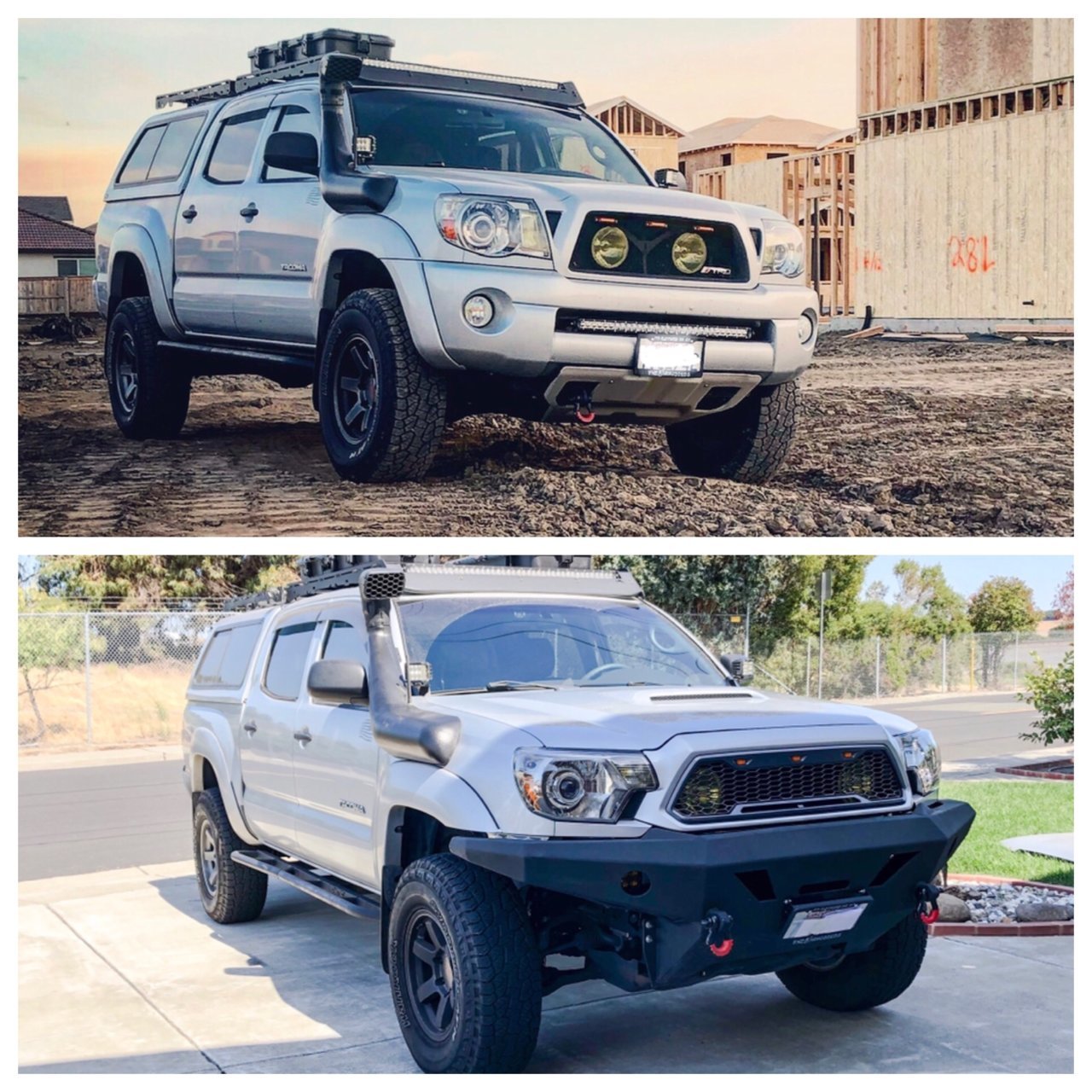

    To get the headlights to fit, you only have to purchase the headlights and the grill right? Or do you have to replace the hood and everything else as well?

    Thanks man! Yes you will also need the hood to get the headlights to fit, there are different body lines on the 12-15 hoods. Also you will probably want all the upper metal bumper brackets, hood latch support, hood latch, and the headlight plastic filler pieces that go right under the headlight and 2x headlight mount tabs listed above. Hope your conversion goes well, post pics!

    Also if you plan on trying to fit your 05-11 front bumper to a set of 11-15 headlights and grille I don't think they'll line up. It's pretty much all or nothing sadly.
