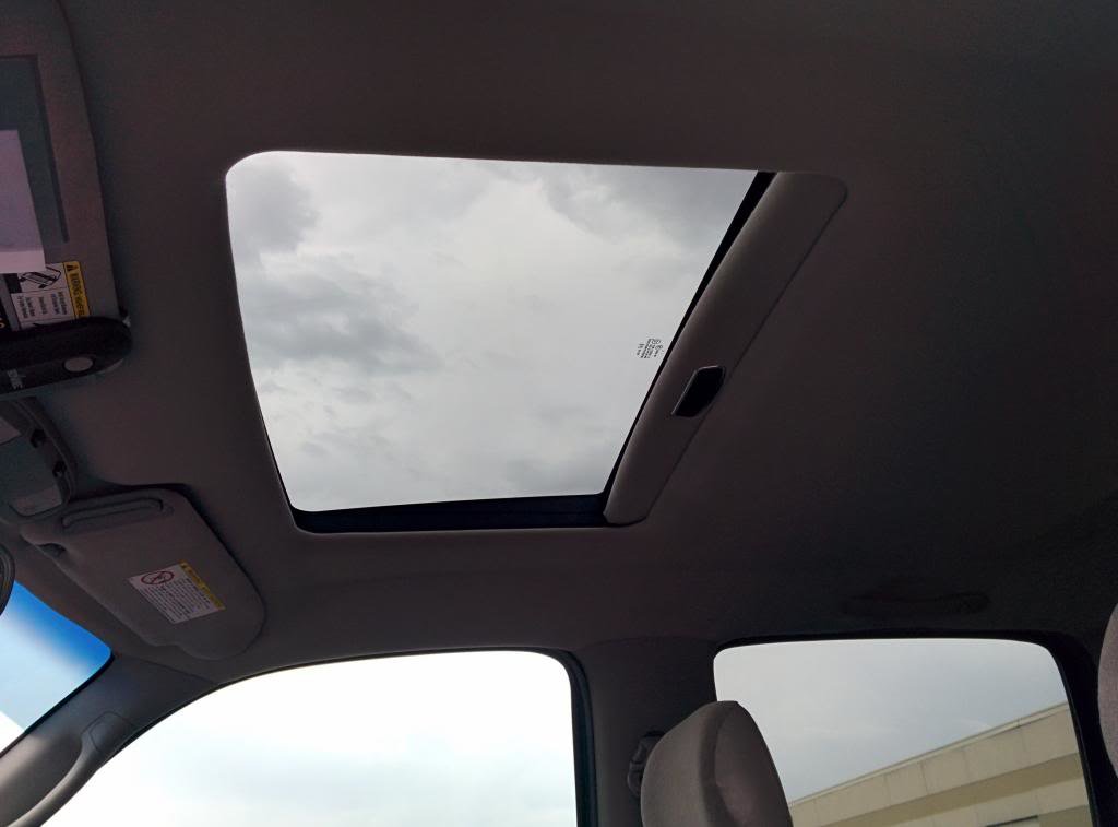

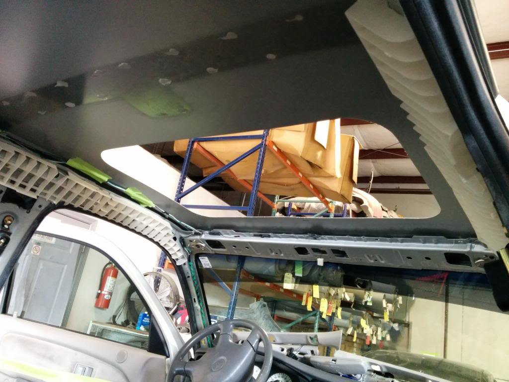

    What's up guys? first post here. I work at a restyling shop here in arkansas Installing sunroofs, & have been installing them since 2006. Well, I picked up my 04 double cab back in feb. & our sunroof supplier (Webasto) offered me a free inbuilt sunroof for my truck to use as a sales example truck. I couldn't turn it down! Anyways, I installed the Webasto 730 inbuilt Roof & it came out perfect.

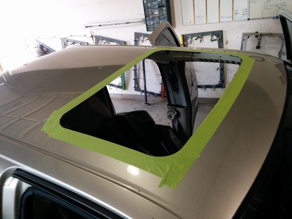

    started by measuring out my hole & getting it cut & prepped for the roof to go in

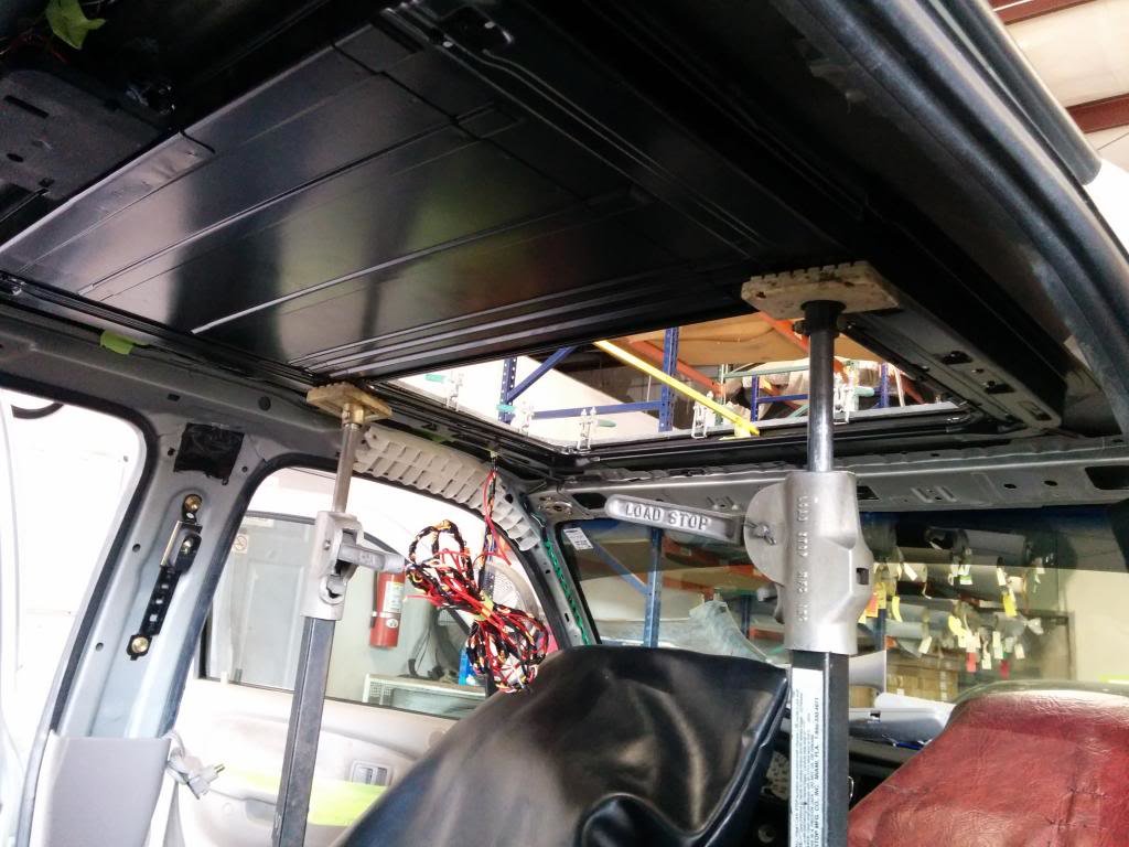

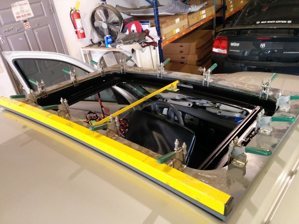

    next got the Roof in & clamped up using a loctite two part metal to metal bonder

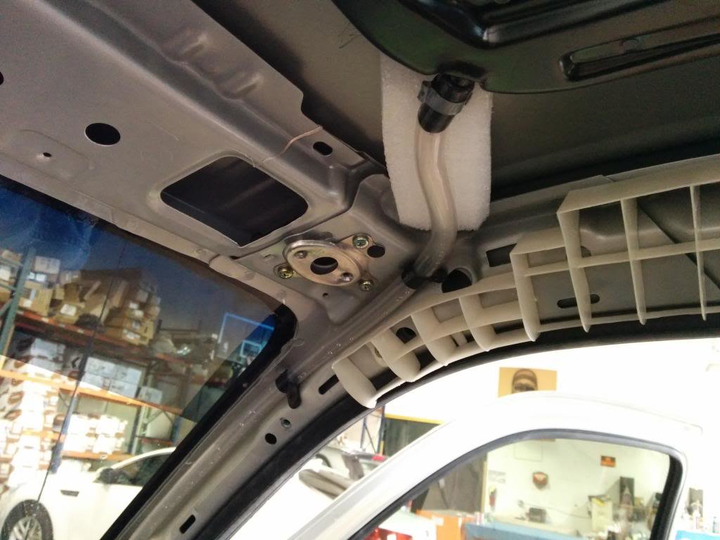

    next I attached the drain tubes & applied a solid foam above them to prevent any chance of them going uphill over time & causing a leak. All the tubes exit the bottom of the truck at the factory toyota drain hole locations.

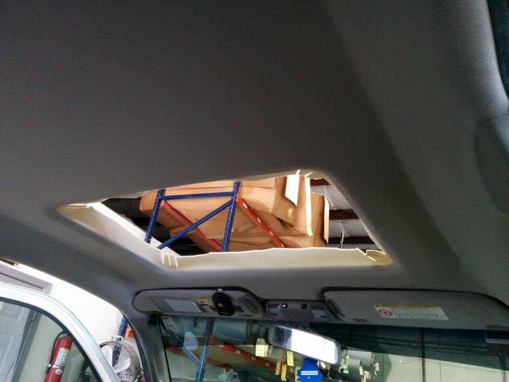

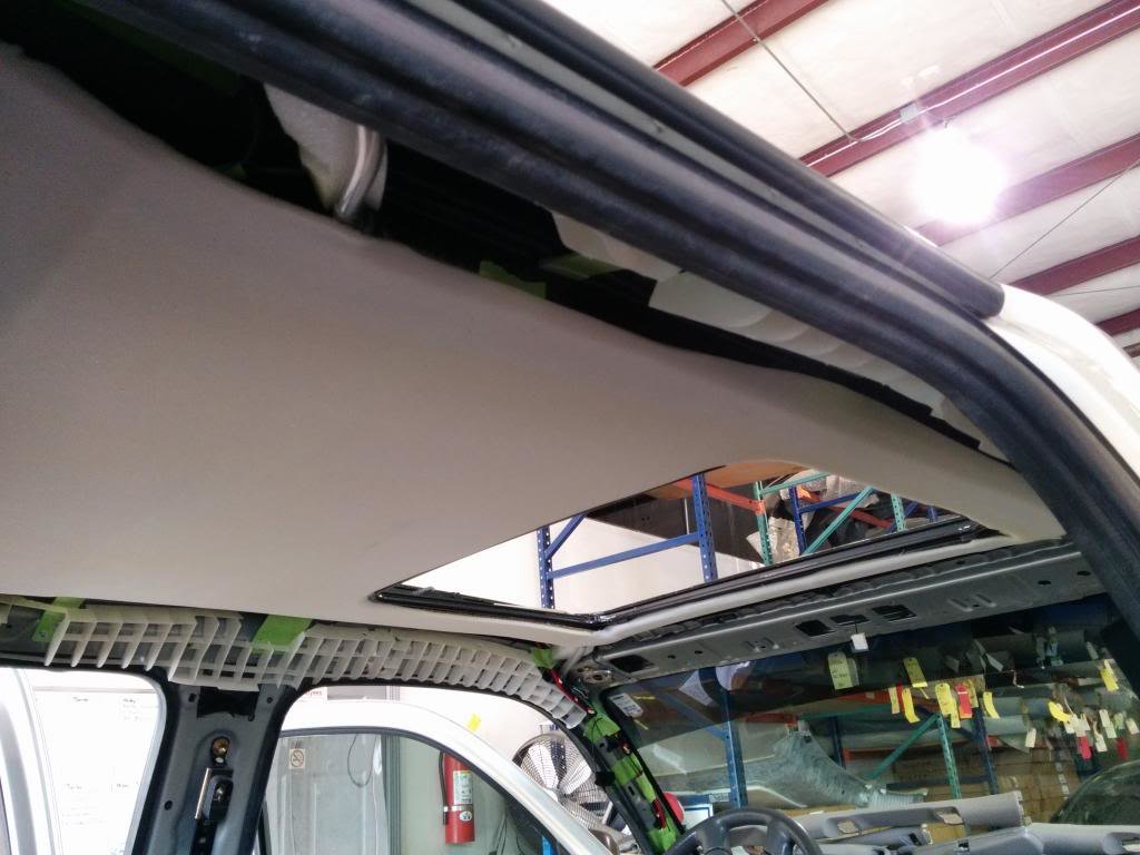

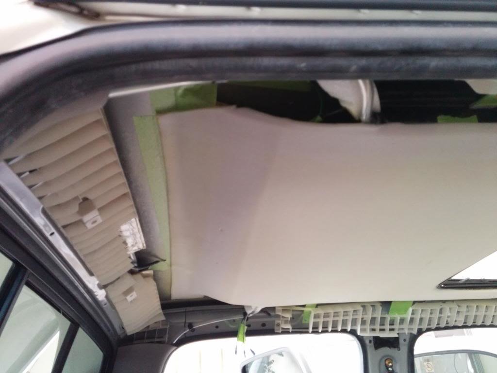

    Next since I have to cut the factory headliner board to make room for the sunroofs body, I decided to make a one off headliner substrate board & attach it to the sunroof wrapped in foam so in the end, the trucks headliner can remain as solid as possible. (most aftermarket roofs have a "floated" headliner)

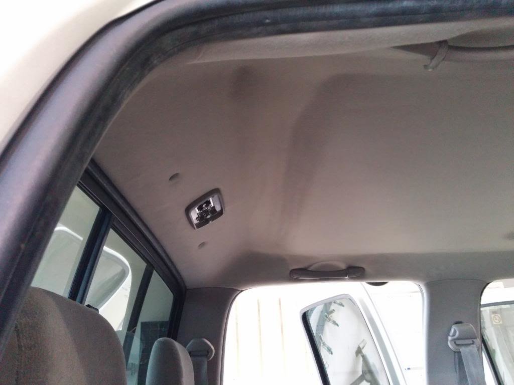

    also I opted to move the factory dome light to the rear of the cab

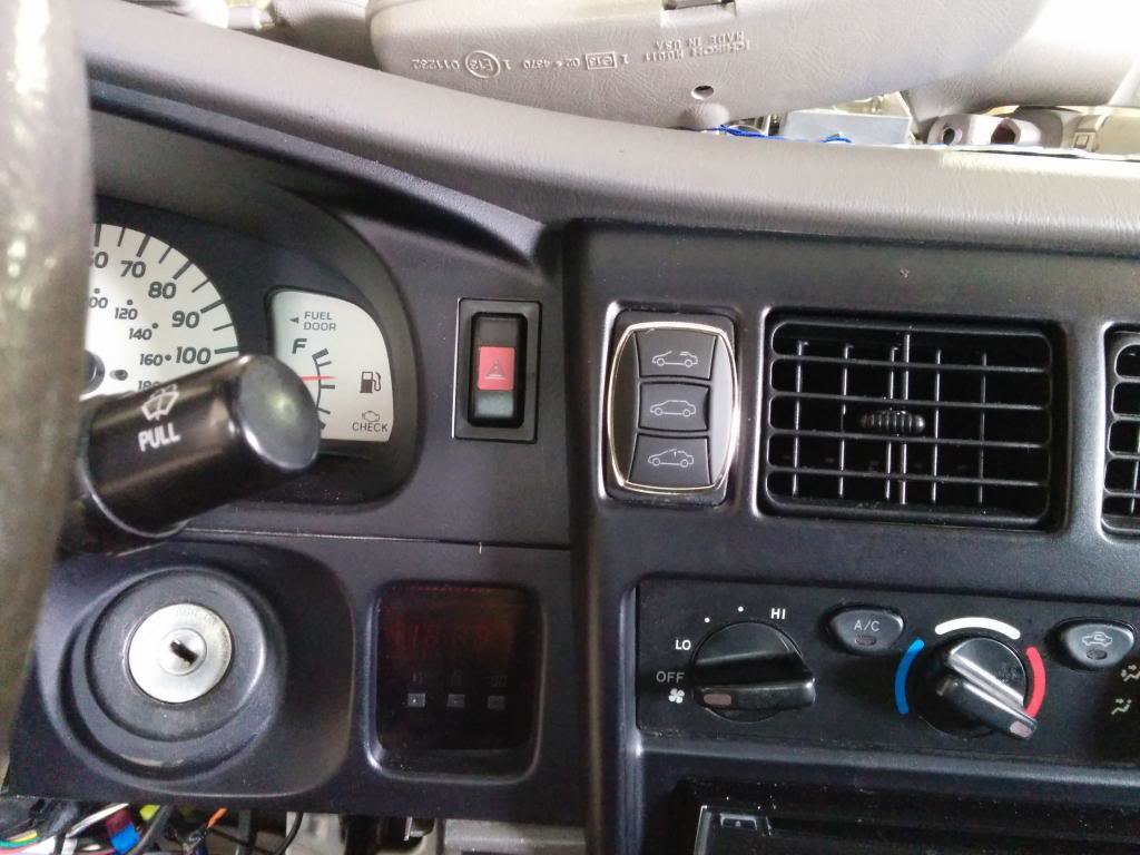

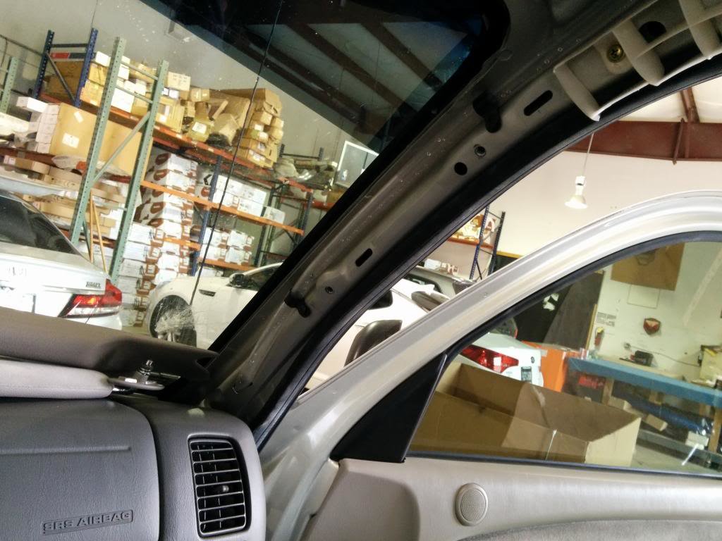

    I chose to mount the sunroof switch in the dash just left of the center air vents ( tight fit btw :p)
    lastly I cut & recovered my headliner with fresh factory matched fabric & installed it in the truck
    It came out awesome in the end & I couldn't be happier with it.
