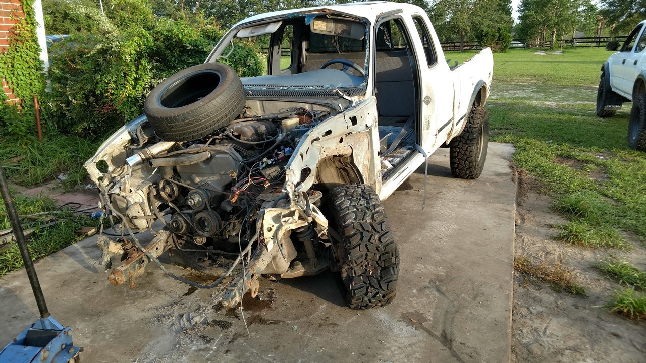

    Here's some pictures of my Taco the day I brought it home. 163,xxxmi. when I bought it, currently at 218,xxxmi. after a year of ownership.

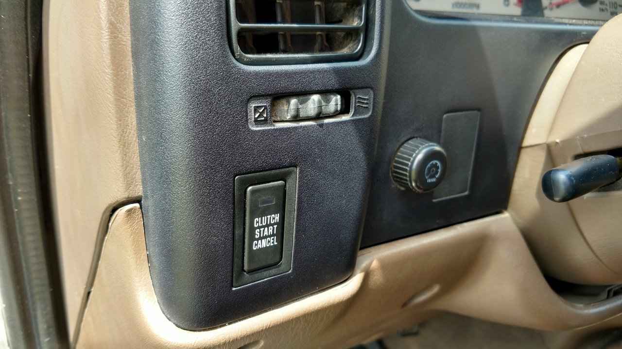

    Clutch pedal, manual brake pedal, and clutch start cancel. IMG_20170724_143320004.jpg
    But where's your RR Diff Lock button, your truck is TRD isn't it?

    Here it is! We all know the clock placement in these trucks are sub-par to say the least... It's actually quite terrible, so I had an idea to get an OEM Land Cruiser Rotary Diff Switch and put it in place of where the clock was.IMG_20170724_145836561_HDR 2.jpg

    A little busy at the moment, so I figured I'd post a picture of the truck I bought to get some parts and part out.
