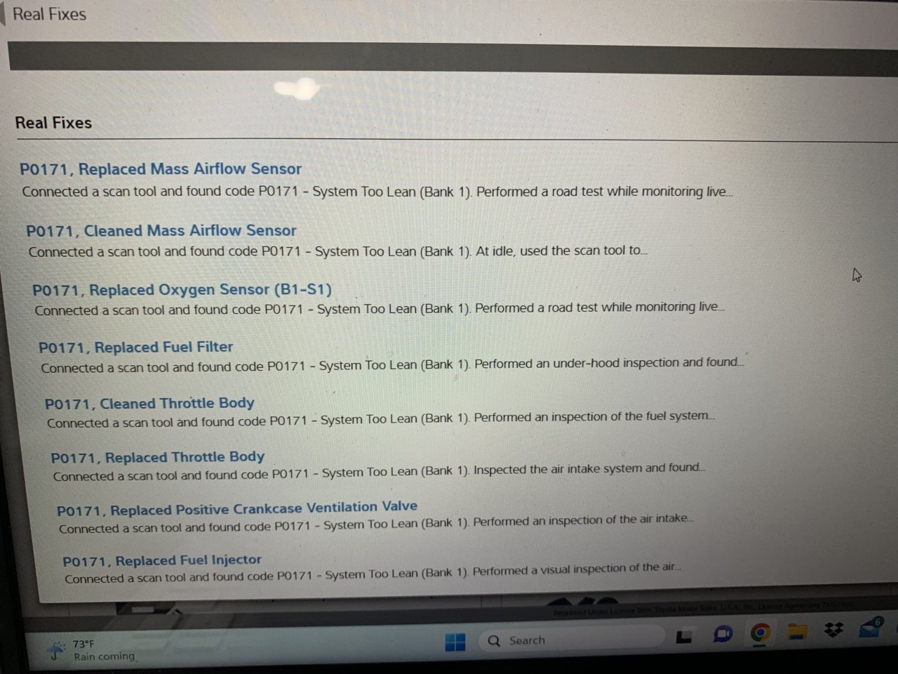

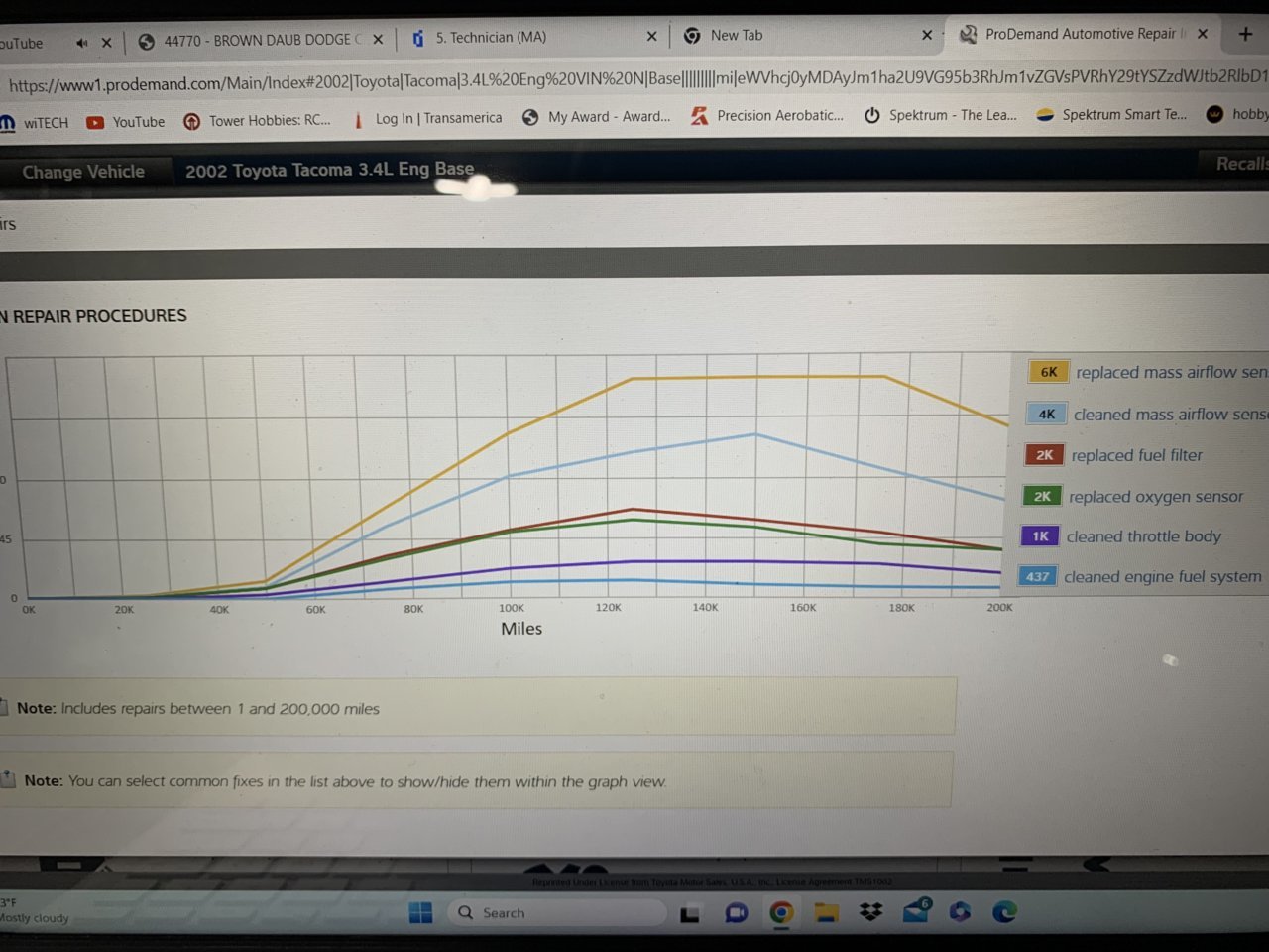

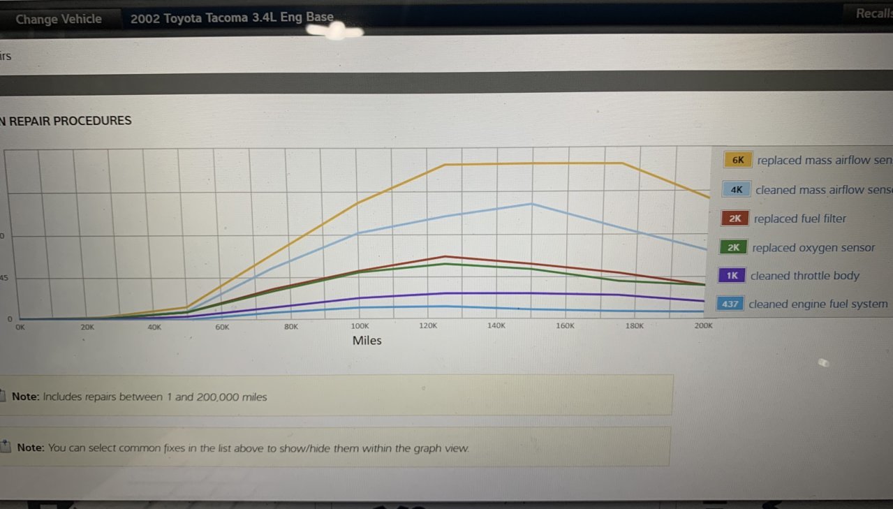

    Update, after 1000 miles, no code has come back on after cleaning the MAF sensor, knock on wood. Also for future reference here is a diagnosis lookup from a mechanic i know on code PO171. I did find the proper MAF cleaner, the first gen tacomas did not use karmen vortex maf sensors.
