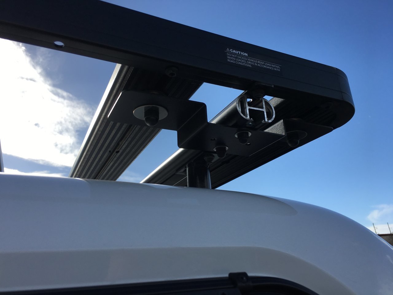

      Question, I'm looking to get the ARE CX HD also can you tell if is possible to add another cross bar? I have the CVT MT Denali (CVTs biggest tent) and i want a shell and notice the CX HD.
      any info will help thanks. ps. sick rig..
    • Mario_Kart_Offroad
      Hi, I have the ARE CX HD as well. I really like how you mounted the FrontRunner Bed Rack to the HD Load Bars. Can you tell me about the hardware you used? Did it come with the mounts? What about the spacers? Any help would be greatly appreciated!
      Thanks in advance, Jay.
    • taco_ace
      I ordered the Front Runner Thule Slotted Rack Adaptors as the main pieces: https://www.frontrunneroutfitters.c...aptor-plates-for-thule-slotted-load-bars.html
      Get some T-nut/slot nuts to slide into the bars.
      Also 1" aluminum spacers to raise the rack to match the front cab rack. A bunch of washers and bolts as well - some of the parts from the ARE bars are reusable on the install.
      It took about 3 hours to attach due to having to free-ball the install.
      Let me know if you need any other photos or part numbers!
      Cheers
      Good info, and thank you for the link. I'll find some T-nuts at the hardware store, or maybe Amazon. Any particular size? 1" spacer! That's what I needed. Also, do you have the regular front Cab Rack or the Slimline low profile in the front? Thanks again for your help!
