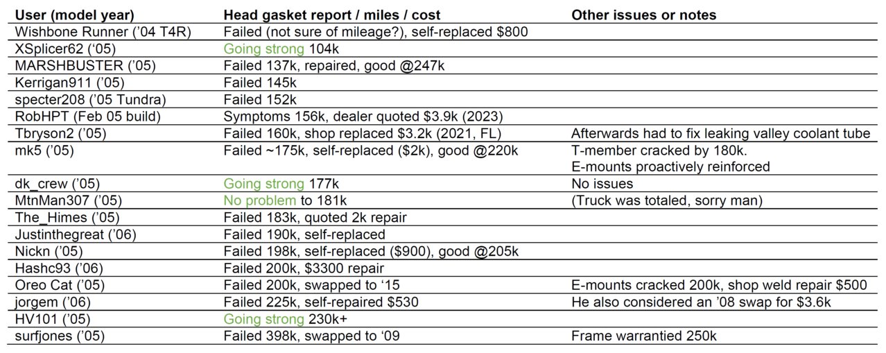

    Summary of people's reports
    This is collected from people's responses to this thread, as well as what I found on a few other threads linked below. I can't figure out how to post a table here, so I had to do an image instead, which is too bad because I can't link to each report. Oh well:
    Keep in mind that the reporting bias here is highly skewed towards people who've experienced problems. A vast majority of these early models are probably doing just fine at very high mileage!

    Problem 1: Weak head gaskets on V6 engines
    This should be your #1 concern--early 1GR-FEs were manufactured with weaker head gaskets through late 2005. (This affects 4Rs and FJs too, and may affect early ’06 Tacomas--check manufacture date) They typically fail around 150k miles, and it varies from truck to truck, but it seems that many have failed by 200k miles. I replaced mine around 180k miles.
    Thanks to @Taco'09 and @Hashc93 for clarifying the dates of affected head gaskets:
    The new style head gaskets do not have this weakness, and if you replace the head gaskets, you will get the new style. You can read about my experience replacing the head gaskets here. Another good resource is @Wishbone Runner 's thread, starting around here. There are probably other good threads, and as I find them I’ll add them to the list:
    Diagnosis: If your truck has the old head gasket design, then you are at higher risk of eventual failure. But there are a number of ways to identify the onset and progression of the problem discussed in the above referenced threads, including:
    • Check the build date on the door plate, or look up the VIN. If it falls within the range of doom (through 10/2005), then it has the inferior head gasket design. I believe that all ‘05s are affected.
    • Swooshing noise from dash on cold startup
    • Smoke/steam from tailpipe on cold startup
    • Bubbling in the coolant reservoir, even after prolonged running
      • Here is a more detailed thread on this topic, with a diagnostic approach suggested in post #7 that might help localize the problem. I wouldn't bother with this amount of effort for an '05 with bubbling coolant, though... if it bubbles, it's time to change the HG!
    • Combustion gasses in the coolant (your mechanic can test for this). Be aware that I've heard of negative CG tests for trucks with early-stage head gaskets failure. It starts as a very small leak.
    • Coolant pooling in cylinders 4 or 6 after cooling overnight (pull plugs to look; also, inspect all plugs for varying appearance)
    • Misfires on startup, eventually progressing to codes, typically for cyl 4 or 6 (P0304 or P0306), but possibly others.
    Pro tip: If your aging early 1GR-FE has ONLY misfire codes, then you might simply have an ignition problem such as coils or plugs. Here's an example of someone solving the dreaded P0304 code by replacing a failed coil pack. But, if you have symptoms such as swooshing sounds at startup, or bubbles in the coolant tank, then you don't need to bother with elaborate diagnostic tests or replacing ignition components in hopes of avoiding the inevitable: The fact is that you need to replace your head gaskets. This is a well-known and solvable problem for these engines.
    Solutions:
    • You can replace the head gaskets yourself for relatively modest cost, e.g., $800 as reported on WR’s thread. I spent nearly $2k, but also bought lots of tools, and made lots of elective replacements including most of the belt-driven accessories, cooling system, and some sensors.
    • You could have a shop replace your head gaskets, which I’d guess would cost $2-3k+, and probably even more at a dealership these days. If anybody has prices for this job, let me know and I’ll post them here!
      • Here's a post suggesting a quoted shop rate of $1800 in WA in 2017, the lowest I could find in my brief search.
      • Here is a post suggesting a dealership price of $3k+ in 2017
      • @Hashc93 reported $3300 for OEM parts and machined heads, in Southern CO, below. (Mileage around 200k)
      • Keep in mind that the cheapest shops might use lower-quality parts, skip machining the heads, or re-use components that ought to be replaced--so make sure the quality of repair is in line with your future expectations for the vehicle.
    • You could have the entire engine replaced with a junkyard engine from an ‘07+ Tacoma (or later '06's), or possibly other models with the single-VVT 1GR-FE. I ballparked this at $4k+ myself, but I live in an expensive area, and lack the means to do this myself (or friends who could help). Note that the 2012+ engines have a smog pump system, so additional effort is required to adapt these to pre-'12 applications.
    Recommendations:
    • If you own an affected engine that hasn’t yet been repaired, you should probably budget for the eventuality of this repair, especially beyond 150k miles -- but this isn't something that needs to be done proactively, and perhaps your old-style gaskets will outlast your truck. @surfjones made it to nearly 400k miles on his '05 factory head gaskets, the highest mileage I've been able to find so far!
    • If you are considering buying a high mileage (>100k), not-yet-repaired ’05 (or an affected ’06, check manufacture date), use this information to negotiate a fair price, taking into account your cost of the potential future repair. It is especially prudent to check for signs of failure at purchase, but remember that impending failures can’t be detected, yet will still occur, possibly quite soon. Sadly, this might mean losing out on the purchase, as other customers might not be as well-informed, but you will avoid being caught off guard for a costly repair. On the other hand, this might land you a great deal if you find a truck that’s already throwing codes in a smog state and are comfortable doing the work yourself!
    • Consider the health of the rest of the engine and vehicle before deciding to make this repair. The frames on these trucks are beyond the replacement period. Perform a compression/leakdown test, and/or oil analysis to make sure the bottom end is in good shape, and be wary of oil consumption, which is not a direct symptom of this problem.
    • Don’t ignore the problem indefinitely. This is a gradual problem, and your truck will continue to run for quite some time, but eventually you will cause permanent engine damage via localized overheating or oil contamination.
    • Be wary: HG gasket failures due to actual overheating or other abuse of the engine may have caused substantial damage, such as warped heads. This is not the problem we’re talking about. The early 1GR-FE gaskets fail on their own, not through overheating or abuse, but without degrading the rest of the engine if caught in time, and offer plenty of advanced warning to effect a permanent repair.
    • Be happy: A properly repaired engine is no less reliable than what you’ll find in the ‘07+ models! The new head gasket design completely fixes this deficiency. The failure is easy to detect and repair before any other engine damage occurs.

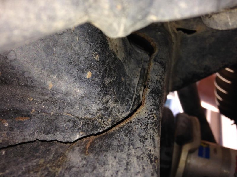

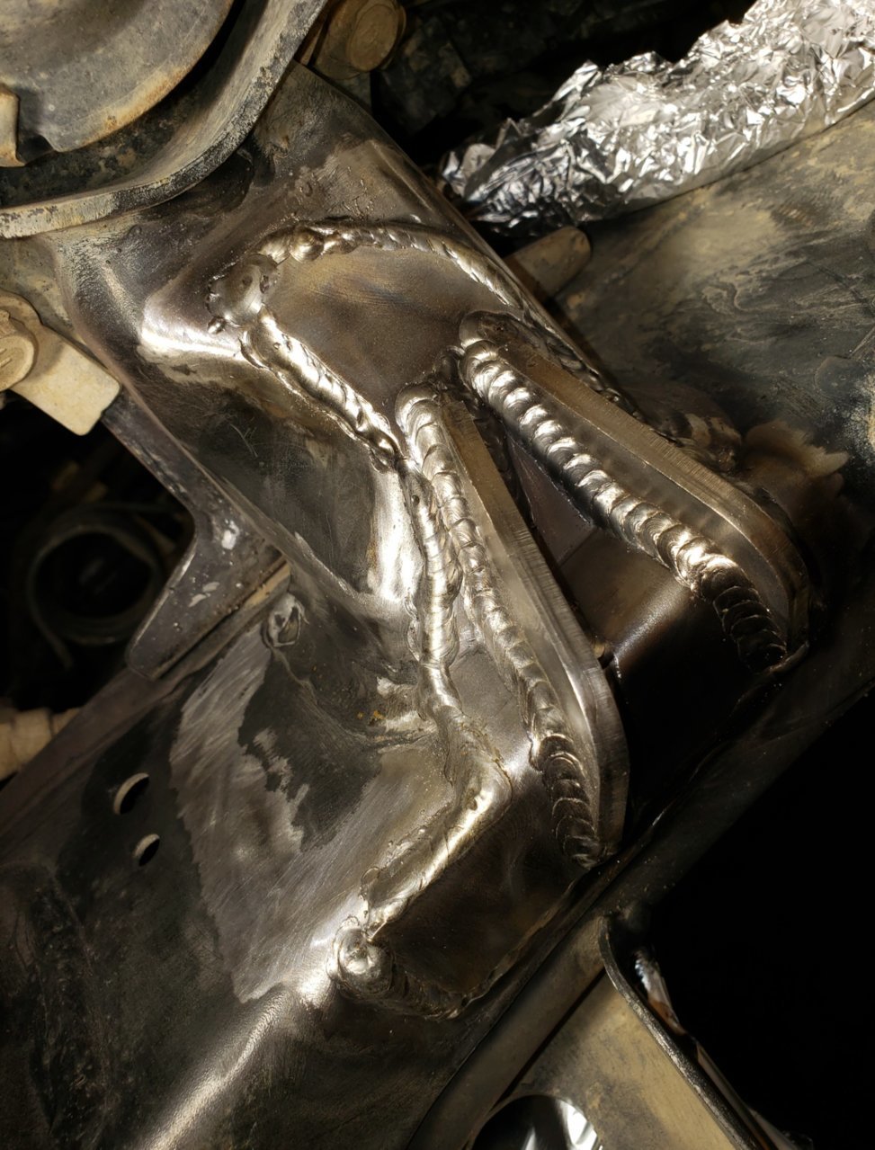

    Problem 2: Weak engine mounts
    Early 2nd gen Tacoma frames used engine mounts that tend to fail with heavy off-road use. Toyota changed the frames by 2007 (not sure about ’06 affected dates), adding additional support to this area.
    Here is a photo of a cracked motor mount, taken from @ColtsTRD in this post:

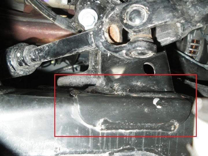

    Here are some photos I am reposting from @SnoBoarder (from this post), showing the difference between the ’05 and ’07 factory motor mounts on the driver’s side:
    ’05 engine mount, viewed from below, steering shaft is at top of photo
    ’07 frame with factory reinforcement

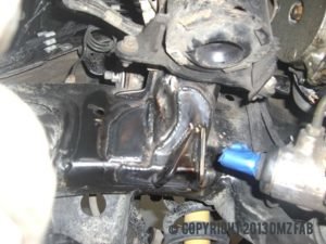

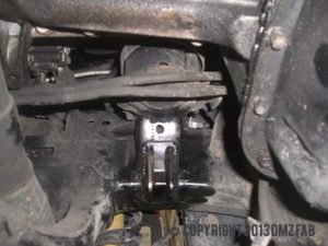

    Solution: DMZ FAB makes a gusset kit consisting of steel plates and gussets you can weld to the frame to strengthen the engine mounts.
    These photos are taken from the DMZ FAB website, I hope they don’t mind my using them to promote their products!
    It’s not a simple repair, at least for 4x4s, because the front axles must be removed to allow access to the mounts for welding. I was quoted around $1k in labor for this job.
    There may be other solutions as well, but any of them are going to require welding material to your frame and engine mounts to fix the deficiency of Toyota's design.
    If you’re comfortable working on the truck yourself, but not welding, you can save some of the labor costs by removing the front CV axles yourself before driving to the shop. This isn’t trivial however, as the front hubs are held together by the axle nuts. So, you will have to source outer axle shaft stubs, swap them in, make sure the drained front diff isn’t churning, and tape up the axle shaft holes to keep dust and dirt out during the drive. This is a plan I considered, but ultimately didn’t execute. So you’ll want to discuss it in detail with your shop if you go this route – there may be details I’m missing.
    No, the good looking welds here aren't mine. They come that way. Mine are the sloppier ones around the perimeter.
    I elected to weld the reinforcements in myself, during a project where I already had the front driveline removed. I’m an absolute novice, hobbyist welder, in fact I think this was my third ever welding project. But my mounts weren't cracked at all, so I was confident in my ability to effect a preemptive reinforcement.
    I set up some practice materials under my truck so I could get the hang of welding on my back, and I practiced a lot before starting the job. The key bit of advice I can offer to other novices is to cover yourself in welding blankets until you are 100% sure you won’t have bits of slag finding their way to burn your neck or back (I was on a creeper that perfectly funneled slag to my shoulder blades!) It wasn't the actual burns that led to poor welds, it was the persistent fear of burning myself that made me unable to fully concentrate on the weld. Perhaps I'm just of weak mental fortitude? But once I figured to cover myself in a blanket, my focus returned, and I was able to weld as well as ever -- which isn't great, but was entirely adequate for the repair.
    Recommendation: This doesn’t seem to be as common a problem as the head gaskets, and it probably won’t affect your vehicle if you stick to pavement, or live in a region where rust outpaces metal fatigue. If that’s the case, perhaps all you’ll want to do is climb under your truck to check on the engine mounts from time to time. But if you are a spirited driver, or frequently careen down washboard roads, then you’ll want to consider making this repair proactively, because the reinforced mounts will be strongest if the original sheet metal hasn’t already cracked. But even if your mounts are starting to crack, you can still repair and reinforce the mounts—although you might want to enlist a professional welder if that’s the case.

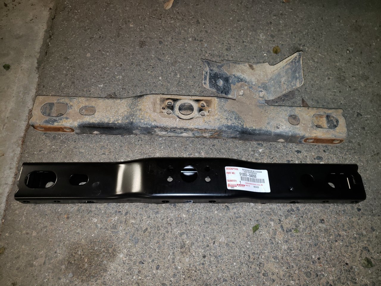

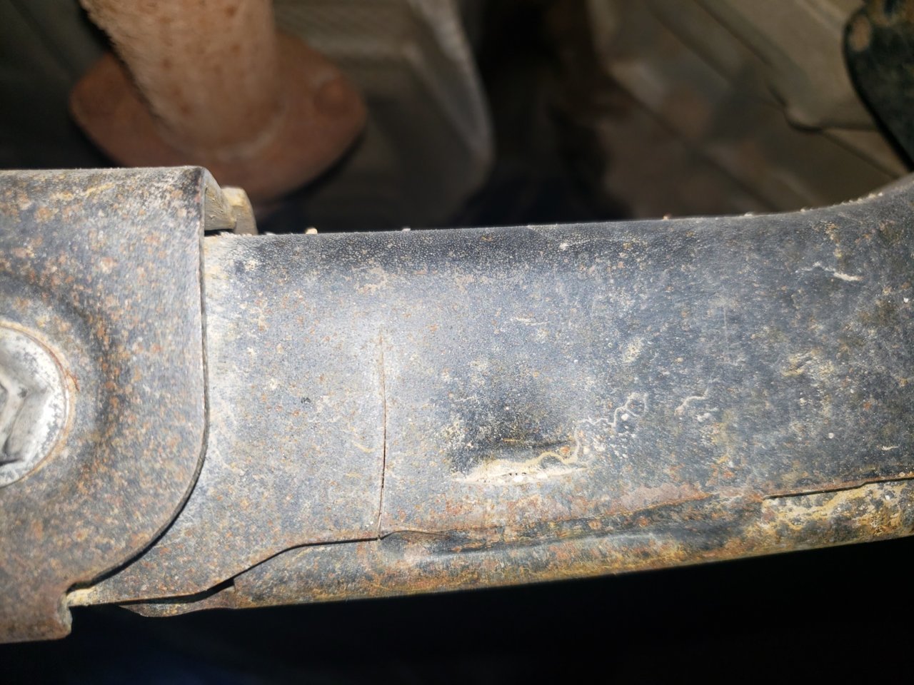

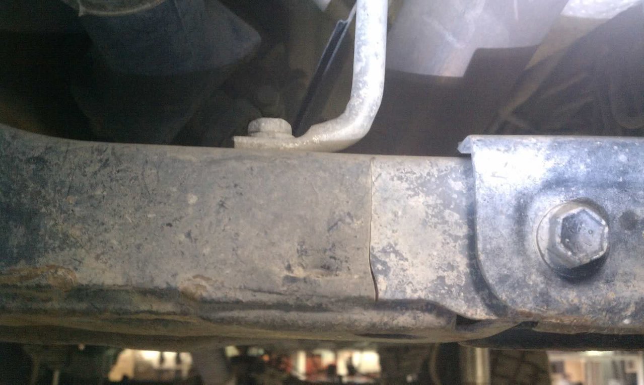

    Problem 3: Weak transmission cross-member (up to ‘09)
    This problem is perhaps the easiest to solve: The transmission cross-member develops cracks with prolonged use, especially off-road. Here’s a pretty concise thread to which I contributed my results as well.
    2011 photo of transmission member support cracking by @MonkeyProof on the above referenced thread…
    As I understand it from that thread, the transmission cross member design was changed in 2009. The new design is less prone to failure.
    Cracks developing in my own transmission cross-member support. Props to @ glorifiedwelder for bringing this to my attention while my truck was in his shop.
    Diagnosis/recommendation: Look at your transmission cross-member from time to time to see if it is cracked!
    Solution: While of course you can weld your OEM cross member to repair the cracks, it is generally difficult to arrest the progression of fatigue failure, so a long term-solution should involve the services of a professional welder. Alternately, you can easily replace your cracked cross-member with the new design, using Toyota part Part #51203-04050. Here’s a comparison between the parts:
    Make sure to install it correctly, i.e., not upside down like I first tried. Other than that, this is an easy fix!

    All V6 head gaskets installed between late 04 and late 05 are not defective, just a higher percentage than normal, which for Tacomas is slightly higher than zero. If all the head gaskets were defective and failed, there would be lawsuits and recalls.
    Nobody knows what the percentage of defective/failed head gaskets is. I think it's more like 5% than 50%.
    Plenty of owners here of 200K+ mile 05 and 06's, they don't seem to get as much attention.
    Hoping my 05 is one of the 200K mile specials, otherwise I have to pay for new head gaskets. My truck is in great, rust free condition. I want to keep it.
    JDTRD01, R0dzilla75, dk_crew and 3 others like this.

    Thanks to all for participating and adding information! I'm adding your insights up top.
    This is a good point, perhaps a better term would be "inferior" or "weak" rather than "defective." Certainly a part that lasts 150-200k miles or more wouldn't be considered defective for automotive parts in general -- a lot of other engines are completely worn out by then. But, the failure rate was obviously high enough that Toyota changed the design just a few years into production of the 1GR-FE, and those changes fixed the relative weakness, leading to a pretty clear bifurcation in head gasket lifespan (at least as far as we can perceive on the forums!)
    I too wish we had stats on what percentage of these fail, and at what mileage. Do we have any readers here driving an '05 with 200k+ miles on original head gaskets? 300k+? I'm sure we'd love to hear it -- especially those who haven't done their gaskets yet!
    This isn't a death sentence for these trucks, just something to be aware of. It's a non-catastrophic gradual condition that is easily detected, and won't leave you stranded. A modestly complex yet straightforward repair is all that's needed to make these engines good for another 100k+ miles. And there are benefits to refreshing the top end on a 15+ year old engine -- they don't have hydraulic lifters, so a valve job and fresh set of plugs will keep them running more efficiently as they age. I enjoy the knowledge that my engine has healthy timing components and oil pump, is clean inside and out, has fresh coolant flowing through brand-new hoses, water pump, and radiator; has freshly adjusted and reseated valves, excellent compression, zero leaks or oil consumption, and healthy oil reports... all in all, quite comforting as I approach the 200k mark on the odometer.
    Edit: I rewrote the HG summary trying to use "weak" or "old-style" instead of "defective." Thanks for the input!
